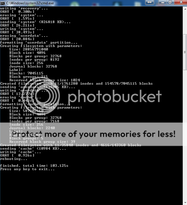

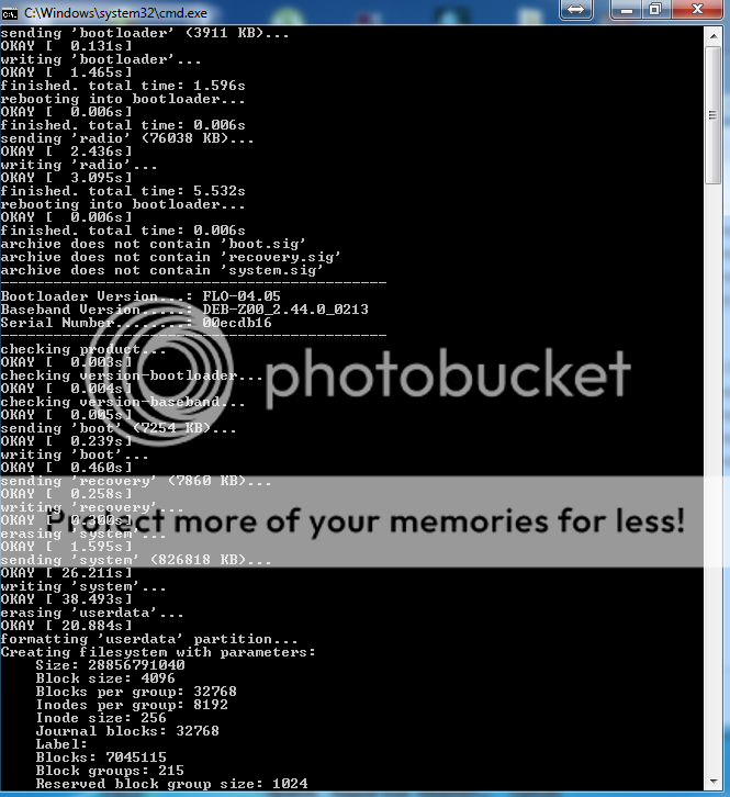

solution connect tab in bootloader mode:
specs:
brand name: nexus 7
date: 2013
baseband number: LMY48u
require board=deb
require version-bootloader=FLO-04.05
require version-baseband=DEB-Z00_2.44.0_0213
firmware: here https://developers.google.com/android/nexus/images#ryu
pasinsya na screen shot lang kasi wla akong cam

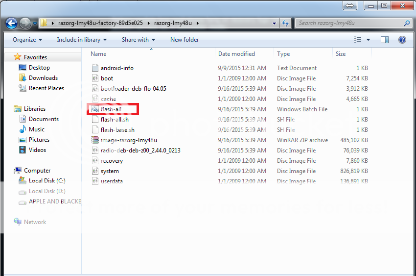

connect in bootloader mode and
just double tick this
