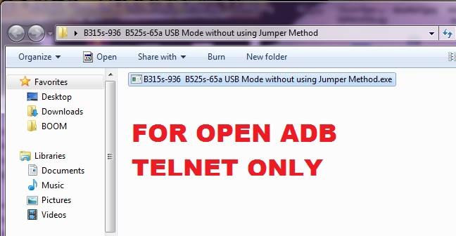

NO NEED JUMPER! (B315s-936 & B525-65A)
credits to Jhowel Gracio Huerto(
Modem s22-s931-s936-Mf283+-ZLT P21-Ro1 Tanungang Wifi)
Para sa mahilig palit palit flash firmware...
WARNING: Hindi pwede sa Locked stock firmware 936 at Locked stock firmware black modem... REQUIRE dati na syang Open Adb Telnet firmware...
1. Connect modem sa pc using LAN CABLE or thru WIFI.
2. Pasukin home gateway sa chrome 192.168.8.1 or kung ano gateway ip nyo.
3. Plug na Male to Male USB.
4. Double click 'B315s-936 B525s-65a USB Mode without using Jumper Method.exe'.
5. type 1 o 2 kung ano gateway ip mo, then ENTER.
6. Kusa rerestart si modem then check DEVICE MANAGER meron na syang PORTS pwede na kayo Balong then flash firmware...
LINK> http://www.mediafire.com/…/B315s-936++B525s-65a+USB+Mode+wi…
