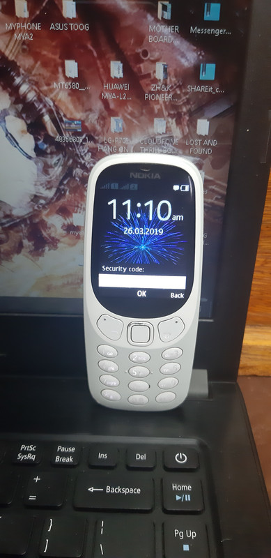

Model: 3310 ORIGINAL PHONE

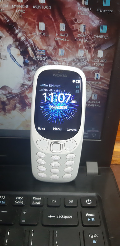

Problem: Security code
solution:

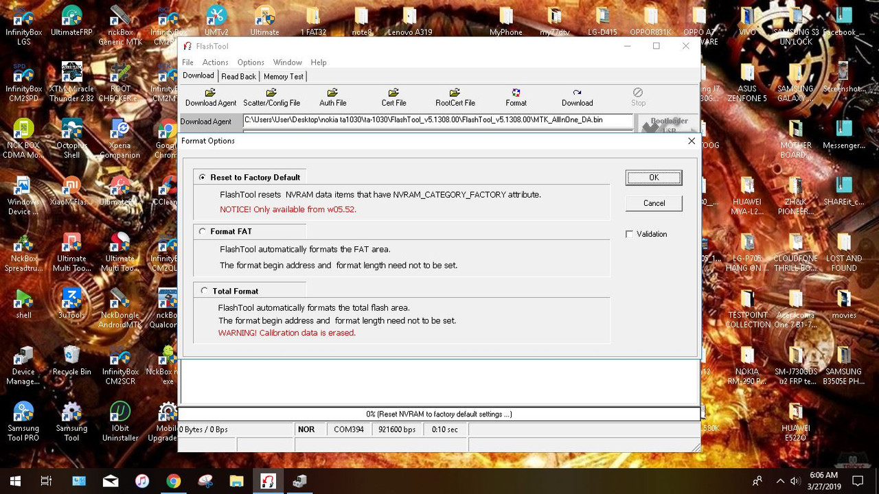

1. install MTK drivers 32/64bit tested on windows 10
http://dl1.infinity-best.com/47/pub.php?dir=software/Drivers/

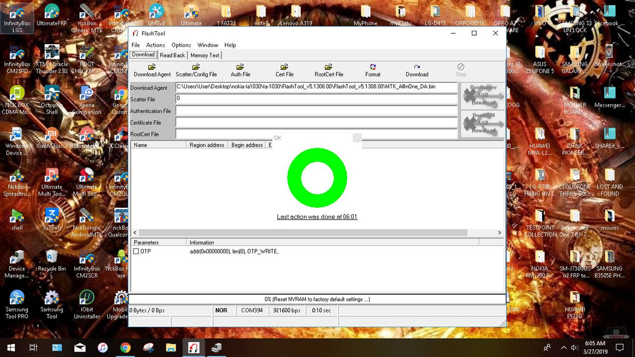

2. turn off phone, press home button, connect cable and format using
flashtool from this link
http://www.antgsm.com/showthread.php?t=255485&highlight=nokia+1030
3. wait and done!!!
