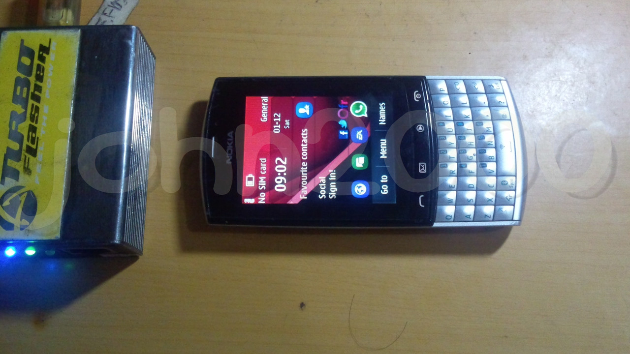

Problem :
Nokia Asha 303 Stuck on Nokia logo
History :
Biglang nag off habang nag tetext
Action Taken :
Reset not done
Solution :
Flash Firmware

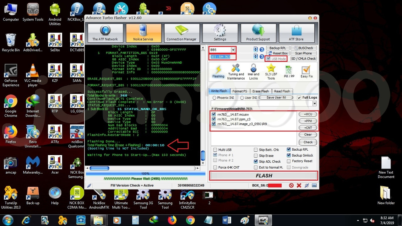

Tools :
Advance Turbo Flasher [ATF]
CA-101 Micro USB Cable
Procedures with Screenshots :
Run AdvanceBox v12.60 GUI
Select BB5 and 303 : RM-763 in dropdown list
Check USB Mode
Load Firmware
Click Flash Button
Remove and reinsert battery
Insert CA-101 Micro USB Cable
Quickly press and release power key [Call button]
Flashing start and wait till done
Result :
Done...
