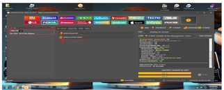

2nd; open po si UT ( unlock tool ) NOKIA section , e type lang po sa search bar C1O . ito po image
click [SPRD] factory RESET ,
at kailngan naka position na po tayo sa (TP) testpoint. din insert USB cable agad , automatic mag rurun na po yan DONE, ito po image
