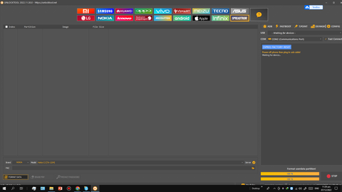

STEPS FOR STAGE 1: REFORMAT SA UNLOCKTOOL
OPEN UNLOCKTOOL
CLICK NOKIA TAB
SEARCH NOKIA C2 ( TA - 1204)
SELECT NOKIA C2 SPD ( 1204)
OFF MO PHONE MO
SA UNLOCKTOOL, SELECT FACTORY RESET SPRD
PLUG CABLE NA NAKA-OFF CP MO TAPOS SALPAK LANG NO NEED VOLUME KEY
RUNNING.....
REFORMATING...
HINTAYIN MAGREREBOOT YAN
DONE...

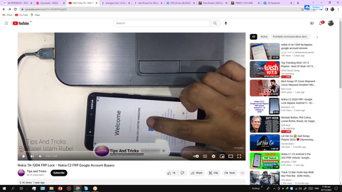

STAGE 2 HOW TO BYPASS FRP? ------------------ OPEN THIS LINK - EASY STEPS :
View: https://youtu.be/NG8lX5GjgXQ
copy and paste on Google chrome the link. Thanks in advance sana makatulong kahit luma na model
