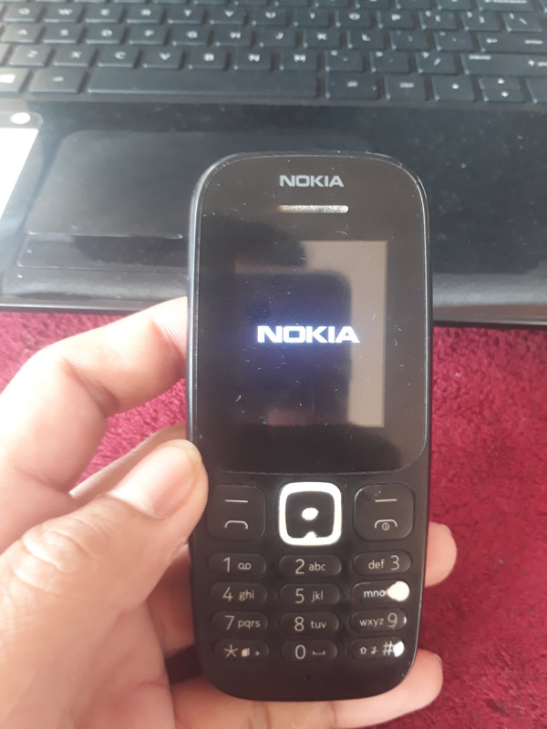

nokia TA-1034 hang logo
naka stock na lang xah ng ganito

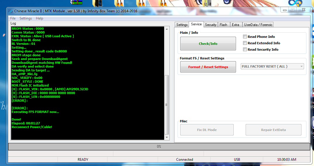

TOOLS NEEDED:
*USB CABLE
*CM2 MTK DOONGLE
ACTION TAKEN:
OPEN CM2 MTK
SELECT NOKIA MTK IN SETTINGS
HIT FORMAT RESET SETTINGS
SS..
upload an image
KUNG MAPAPANSIN NYO ERROR
PERO DONE ..

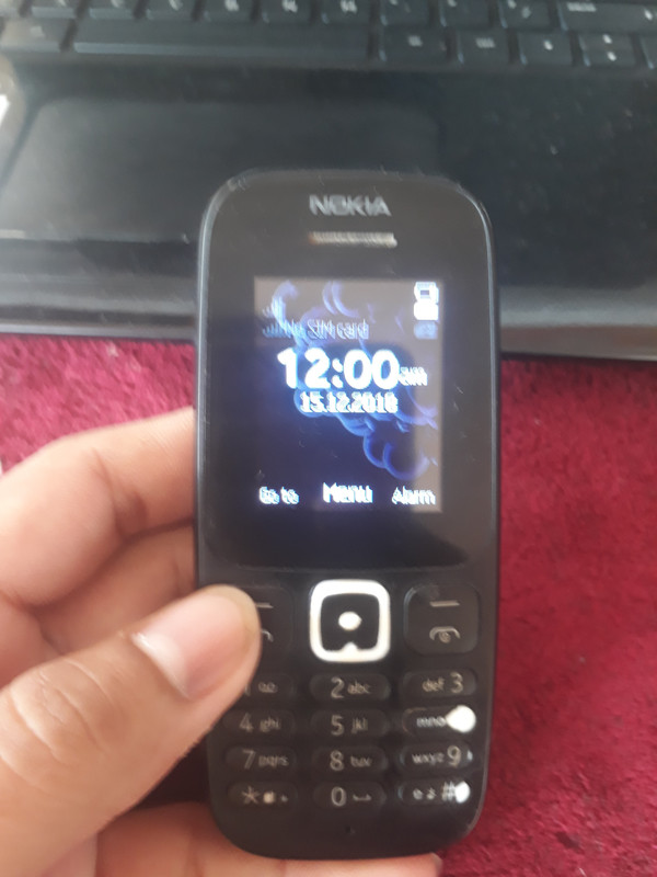

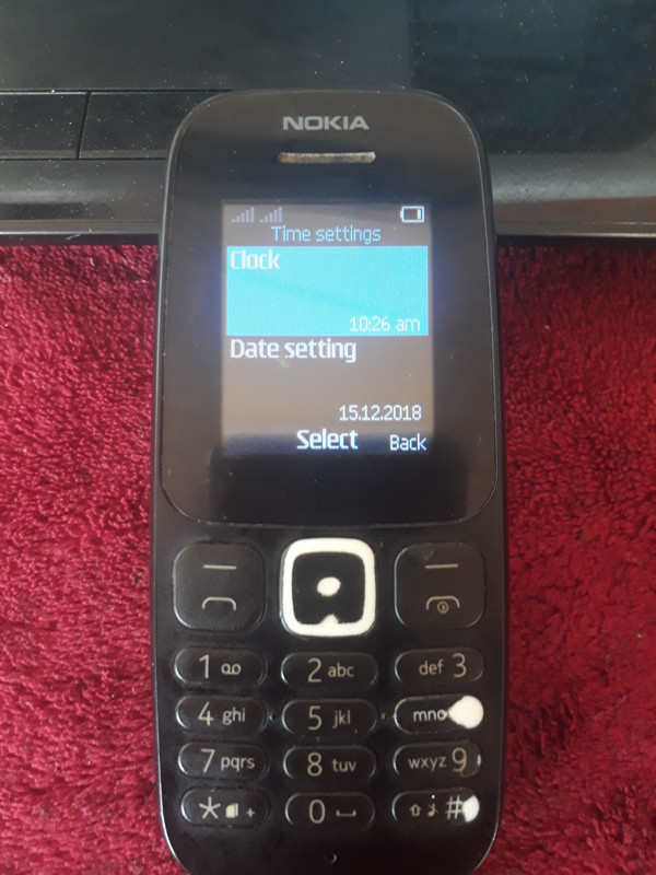

REMOVE NA ANG PHONE
THEN OPEN NA PO OK NA YAN
