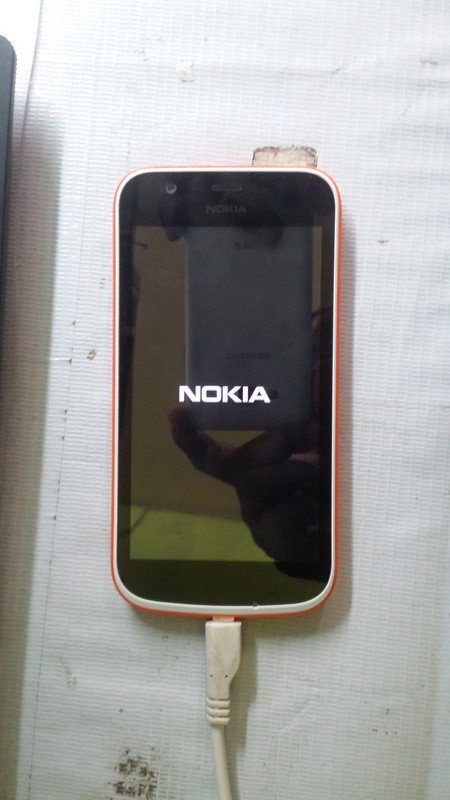

REFERENCE Nokia TA-1047 Hang Logo at Frp Done By MRT
Neth_20
Dec 12, 2014
167
96
Tumauini isabela
History: ng music lang daw at ng off pag open hang na sa logo
Procedure: hard resset ko pero hang parin sa logo
kaya hanap ako solution google my nakita ako sa mrt
Open Mrt select format(unlock)
then check nyo nokia only
click start hold volume up and down as bootkey
sabay saksak usb wait hanggang matapos

boss paano procedure hard reset meron ako pareho any problema logo Lang Hindi ako makapasok say hard reset salamat say reply boss
