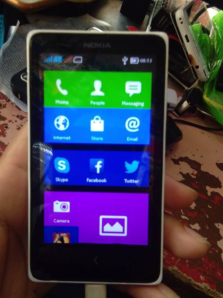

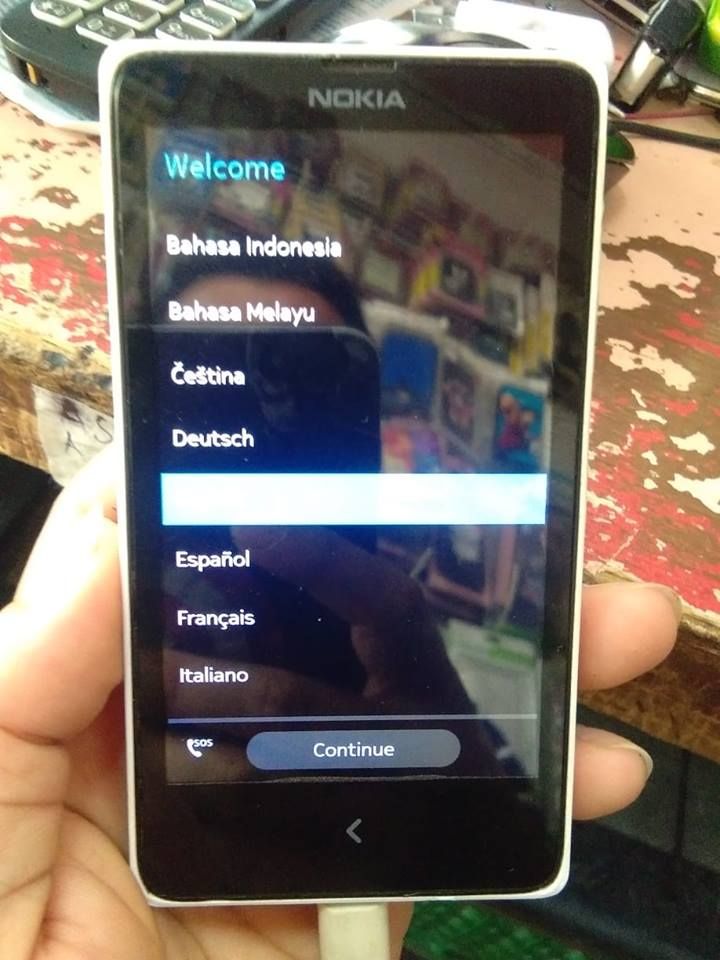

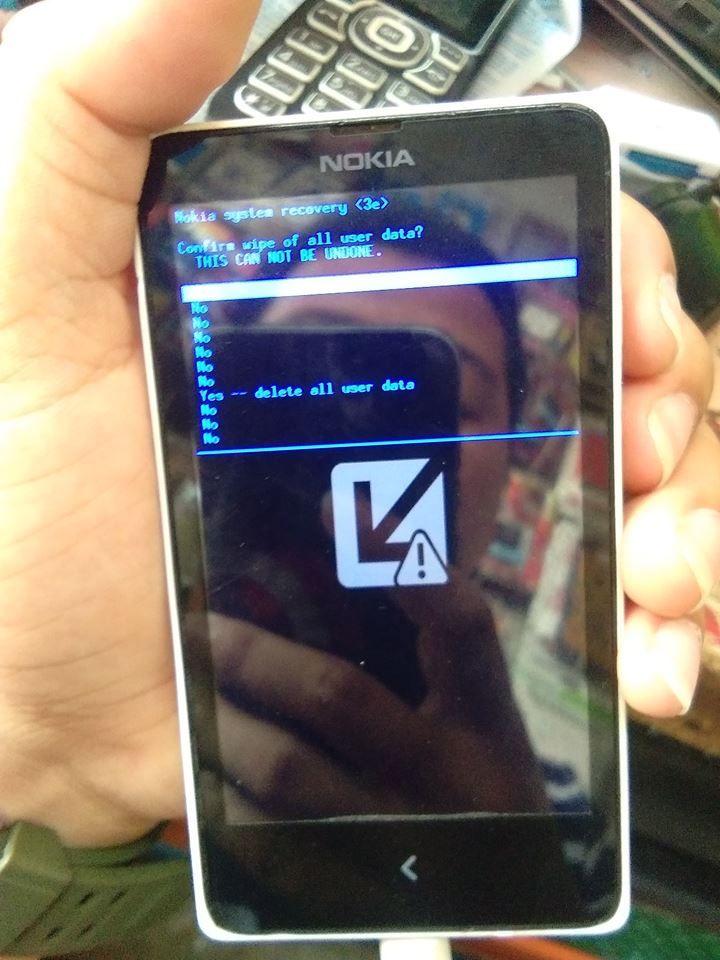

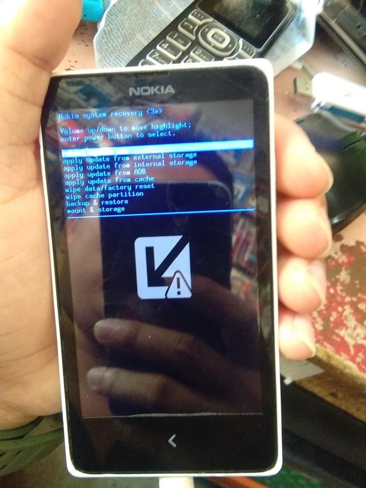

Japtech123 Registered Joined Jun 25, 2018 Messages 146 Reaction score 67 Points 1 Location north poblacion jimalalalud negros oriental Jul 4, 2018 #1 nokia x rm-980 walang menu done sa kamay via reset press and hold volume up+ power button hanggang lumabas ang recovery volume down to select press power on to ok done...
