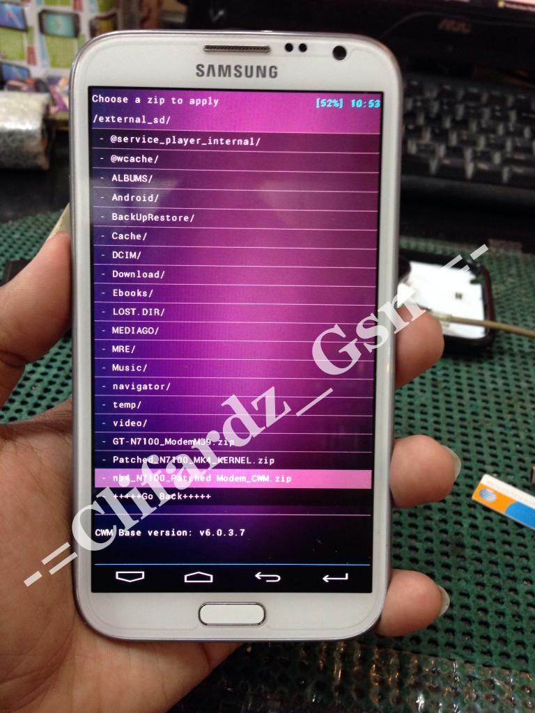

Download Philstouch recovery and flash via odin in pda.
Download nb4_N7100_Patched Modem_CWM
After You Flashed Or installed the Recovery copy the (nb4_N7100_Patched Modem_CWM) to root of your micro SD and install Zip From Sd Card thanks to zuluman.

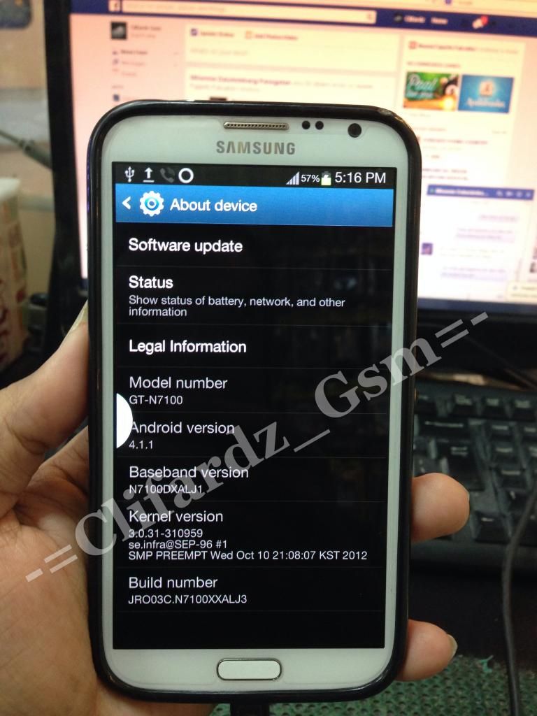

Before 4.1.1

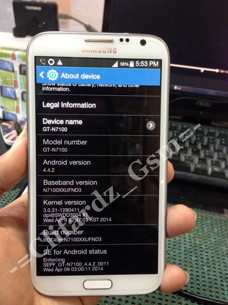

after update to 4.4.2

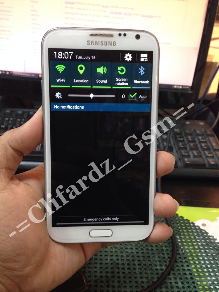

Emergency call only
Install (nb4_N7100_Patched Modem_CWM)

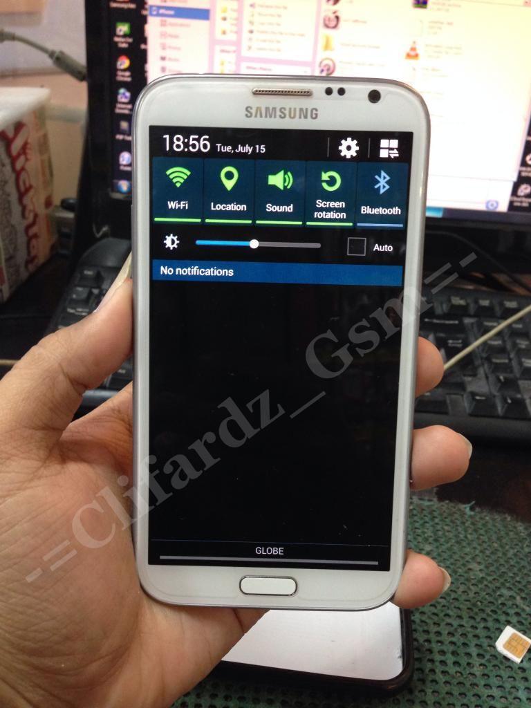

After install patch hayus na.
