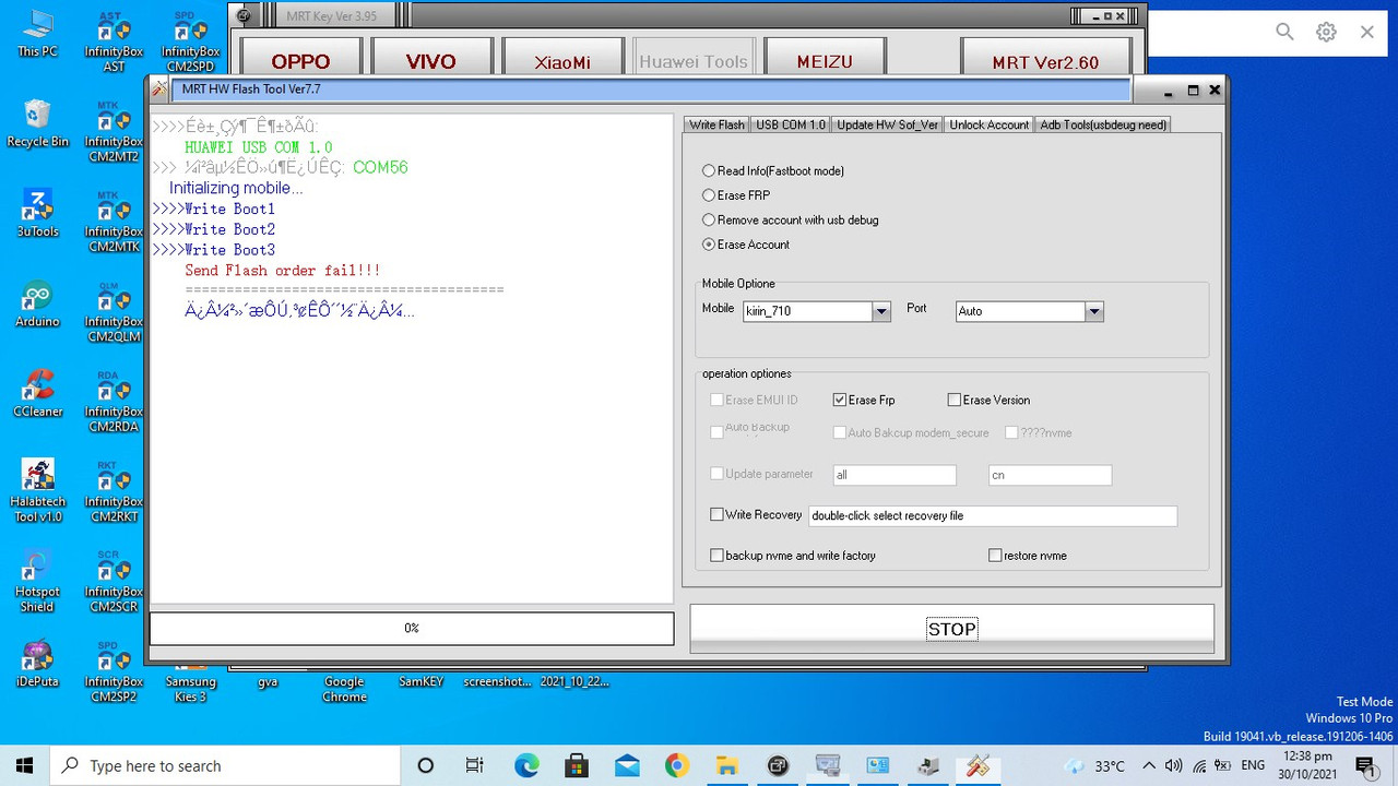

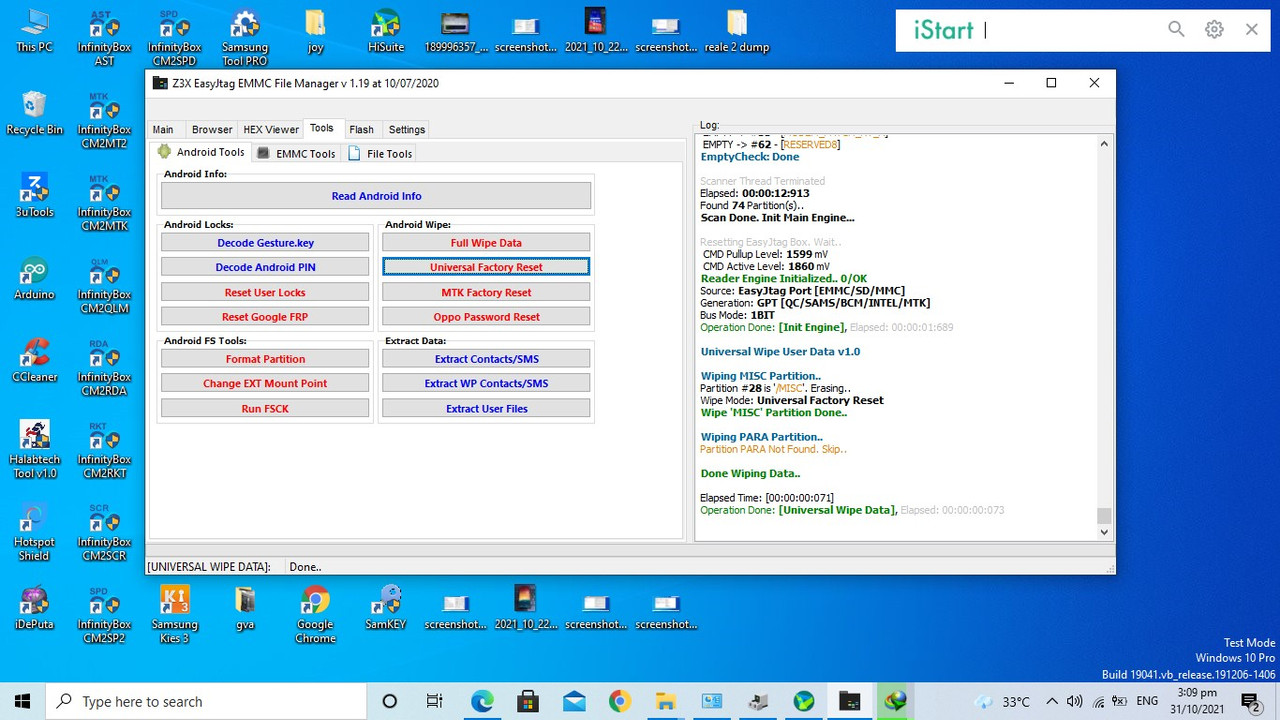

3x kung ginawa kay MRT kahit uninstall ko na ang driver at reinstall pero ganon pa rin
ang error at ayw ko nman e downgrade baka magka aberya pa.
ACTION TAKEN:

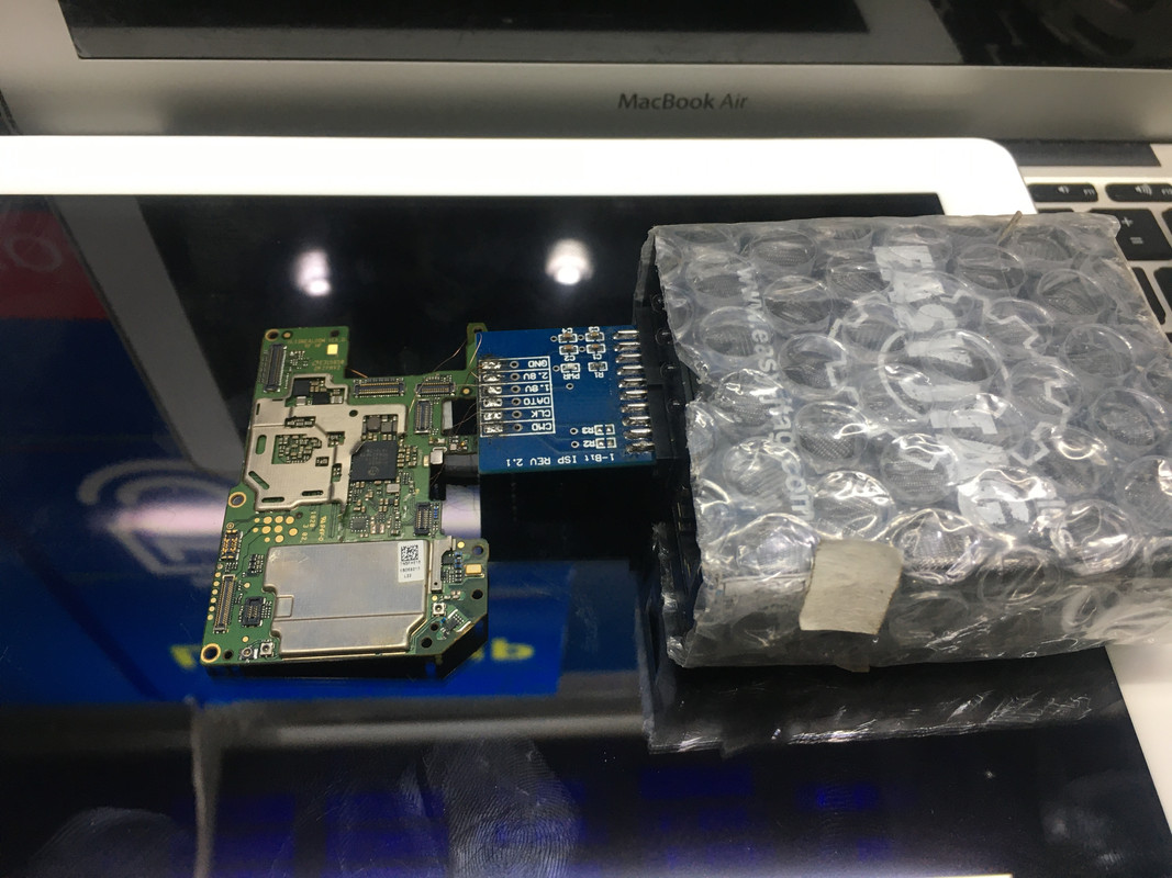

Baklas UNIT

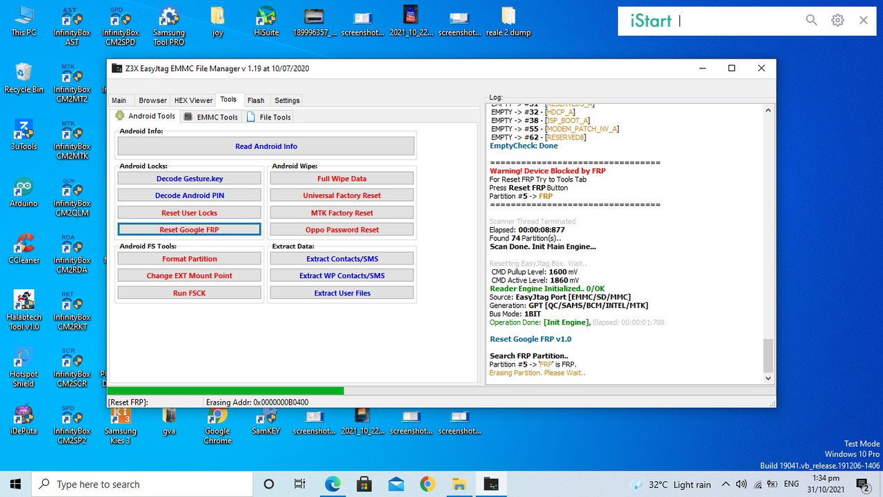

Connect CLK, CMD, DAT0, VCCQ, VCC at GROUND sa pinout
Remove motherboard and insert ISP sa box.

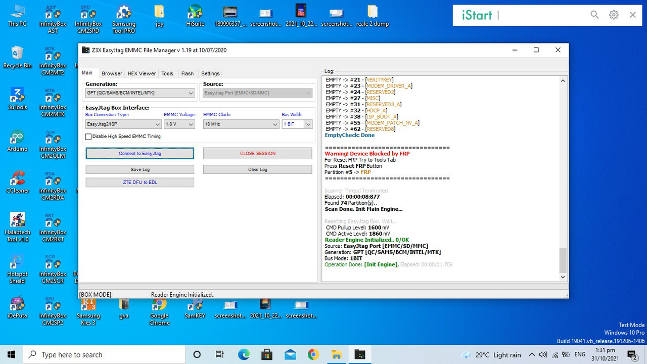

Open EMMC MANAGER
Set VOLTAGE 1.8
Set 18MHz
Set 1BIT
Click CONNECT TO EASY JTAG

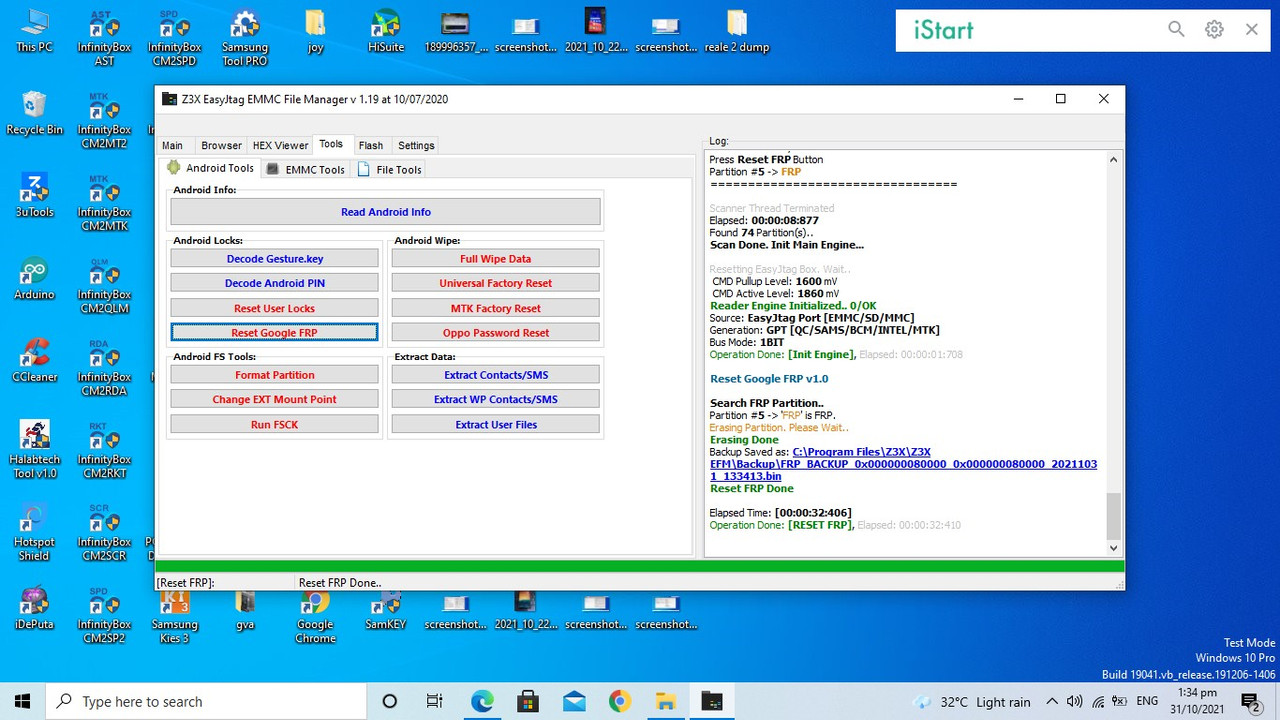

Click RESET GOOGLE FRP
Click UNIVERSAL FACTORY RESET

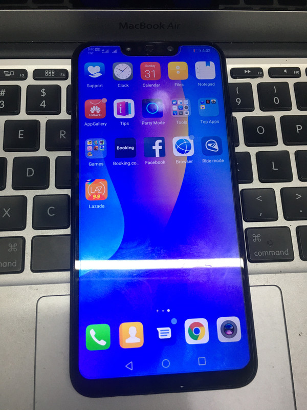

DONE.
