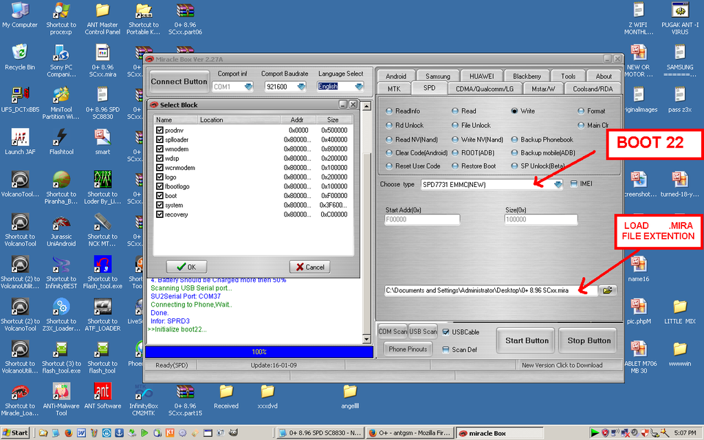

Magandang gabi po mga ka Ants , para po sa walang CM2SPD
Flash file has .mira extention - that means it was backup by Miracle Box.
Follow the instruction below:
Load the flash file, choose the correct boot loader
1. Turn off the phone
2. Press volume up and down together
3. Press start button sa Miracle Box
4. Then Insert Usb to Phone
Info
Flash file uploading : ~H ~H ~H
