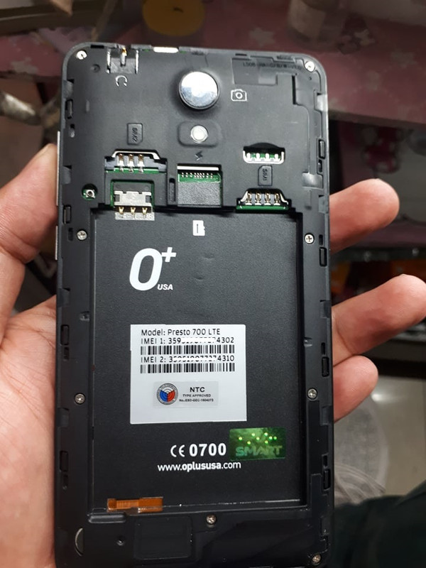

MODEL: O+ Presto 700 LTE

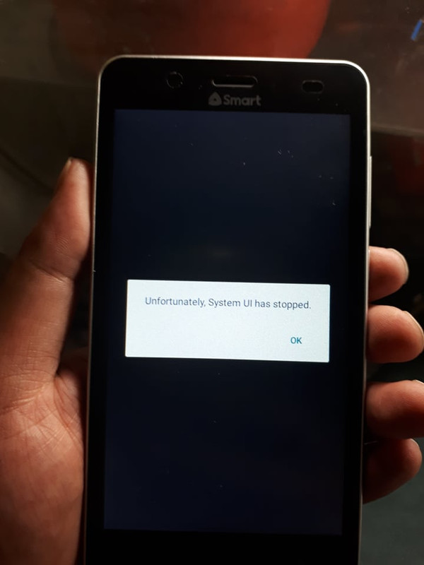

PROBLEM: Unfortunately System UI has Stopped
1st try ko hard reset kaso ayaw

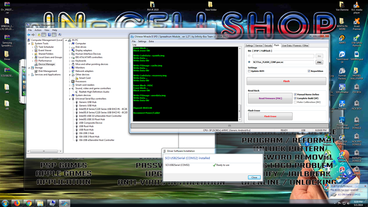

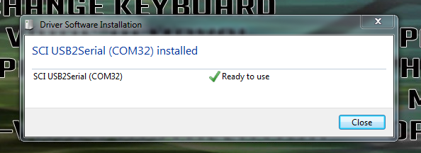

Install driver first dito ako nahirapan mag pa detect driver lang pala kulang hehe
DRIVER http://www.mediafire.com/file/capjlt5kyrptvi1/SCI+USB+2+SERIAL+32B.zip

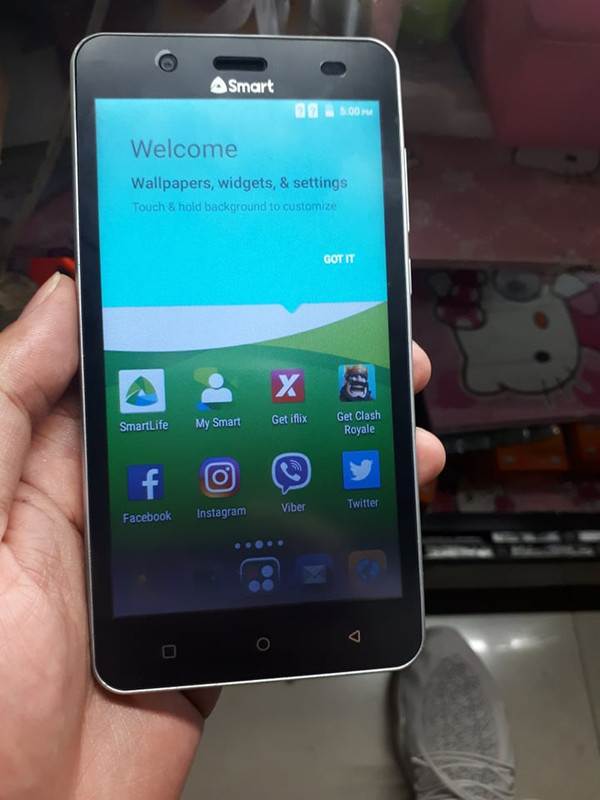

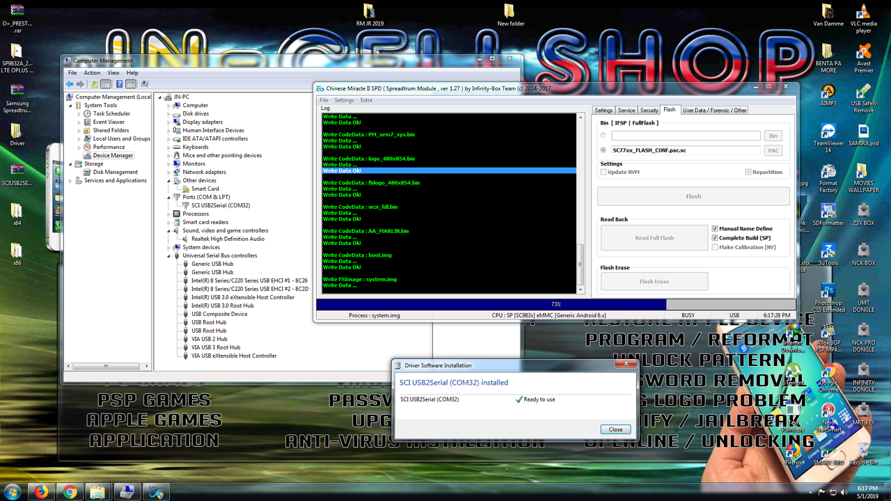

Proceed to flash na tayo Open InfinityBox CM2SPD load pac file and wait until finish
Boot Key Volume up or Down
FINISH PRODUCT
