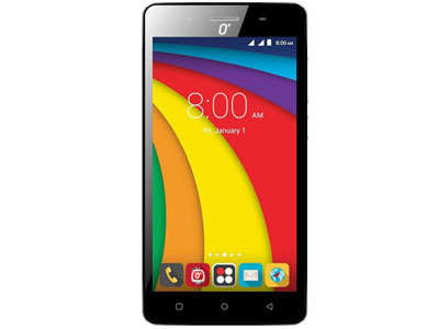

problem
hardreset no luck
format sa cm2 no luck
tanggal flex volumes no luck
decide to flash
then try at success nga po
eto proof kelangan talaga sa post
hit thanks muna
Tested Firmware. kaya lang after flashing may FRP. Remove nalang s CM2
1. Open CM2
2. Select CPU: SP [SC7730..SC7731] eMMC [Crev / Android 6.x]
3. Under Service Tab click Format Fs / Reset Phone / Clear FRP
4. Hold Volume Down then Insert USB to CP
5. Wait mo lang magreboot. DONE
