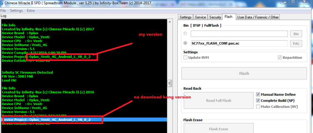

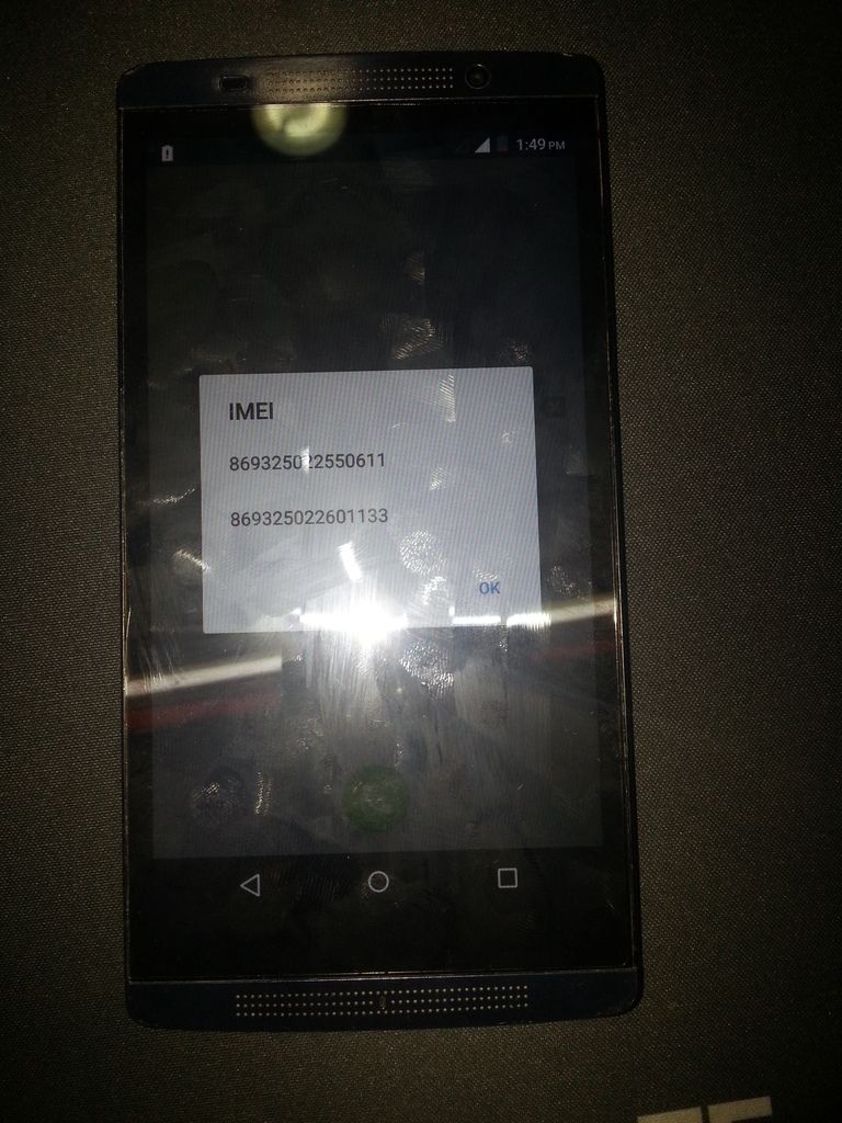

ayus! swak na swak ang Firmware sa unit ko..
NULL IMEI flash ko sa maling firmware..see pics below..
DONE..
many big thanks to TS and MOD Julie for fast reply para sa password..GOD BLESS and More Power mga Ka-ANT
after flash just RESET to Factory Settings
