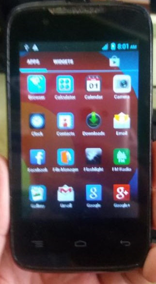

OPLUS 8.36z hang on logo done sa nck crack
NO NEED FW.

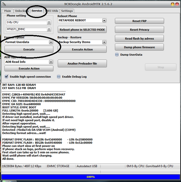

OPEN NCK CRACK AND
1.GO TO SERVICE
2.click FORMAT USERDATA [Execute
3.wait is all done
https://i.postimg.cc/hG3MBdLX/8-36z.png
https://i.postimg.cc/rFShrzkH/20181230-105243.jpg
yan po ang link ng pic. sorry di maka upload ng pic.
NO NEED FW.
OPEN NCK CRACK AND
1.GO TO SERVICE
3.wait is all done
.https://i.postimg.cc/hG3MBdLX/8-36z.png
