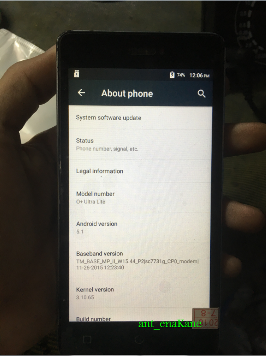

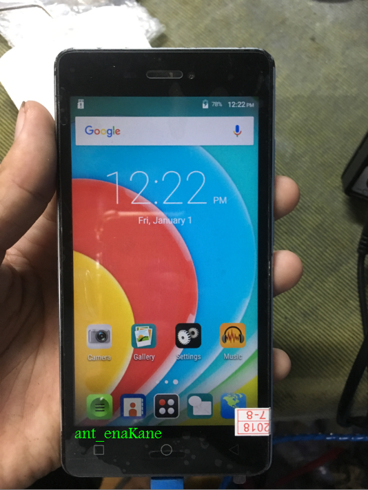

UNIT: O+ ULTRA LITE
ISSUE: FRP LOCK / NO SKIP BUTTON
SOLUTION:

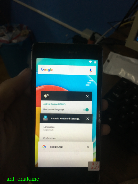

1. Palabasin muna ung BACK, HOME at RECENT BUTTON
(Kung Tech ka talga, alam mo na yan kung pano)
2. Pag kita na HOME BUTTON, Long Press lang/isang click lang boss, ganito lalabas:

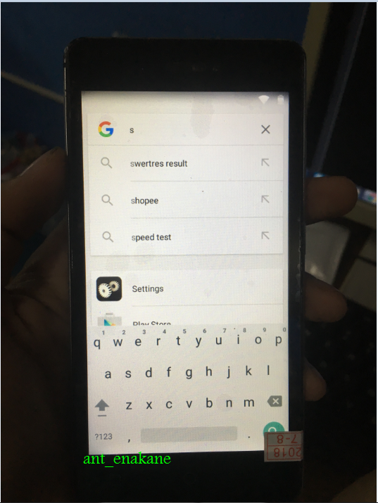

3. Punta ka dun sa Google Search, i-Type mo lang Settings

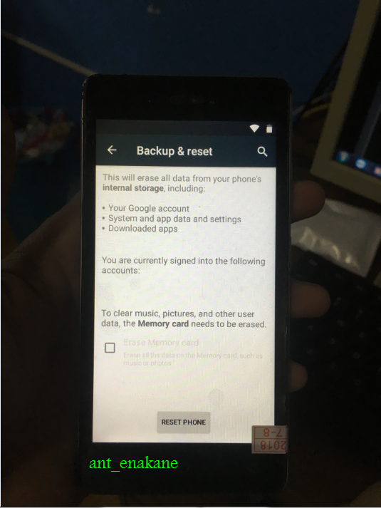

4. Tpos Back Up and Reset, ganito lalabas
5. Reset Phone lang

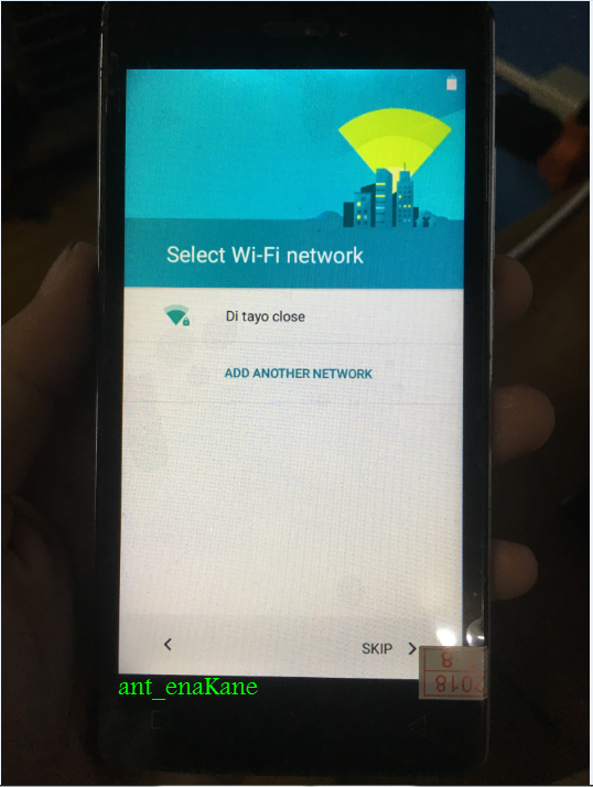

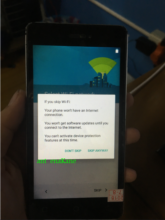

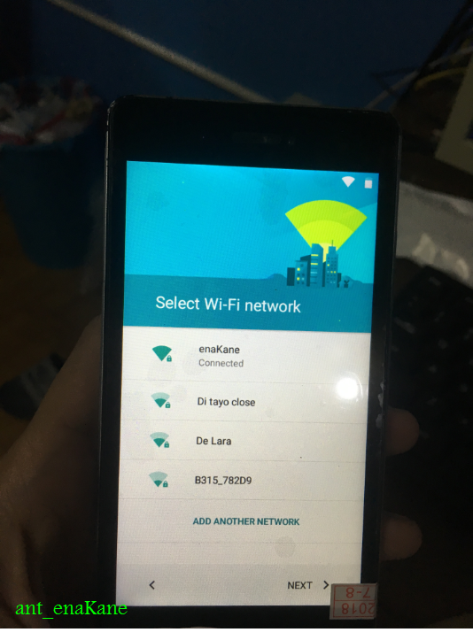

Mag kaka-skip Button na yan after Reset:
DONE na mga BOSS :)
