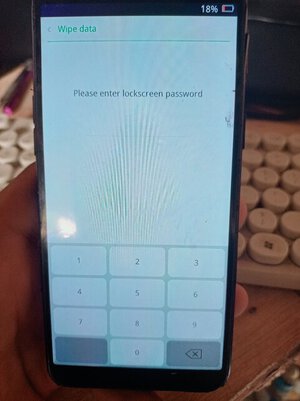

REFERENCE Opo A83 any cph Password Problem and Frp done in metamode sa UT no need Tp

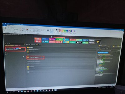

  1. Open UT latest
  2. Prepare UT driver Installer
  3. Click Oppo Tab
  4. Search Oppo A83
  5. Click pangalawa yung may word na meta

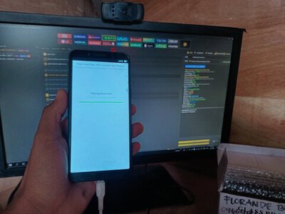

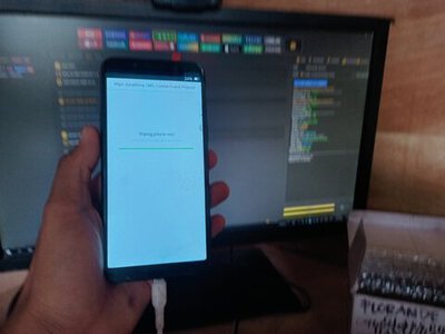

  6. Factory reset Emmc
  7. Power off phone
  8. Hold vol-&+ tas salpak USB wag bitawan hanggat d matapos

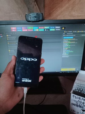

  9. Running.....
  10. Rebooting device ok....
  11. Done
