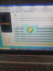

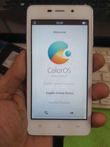

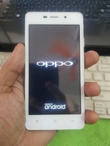

Problem Restart only
Solution
1try ko muna power off at baklas batt at try ko kung mg open kusa pag balik na batt hnd nmn
2try ko sa power supply kung mag open ng normal pero no lock p rin
3 try ko Hard reset no lock p rin
4kaya proceed n ko sa flashing
Ito ung fw
https://www.mediafire.com/file/ccpz..._11_A.02_150601.zip/file?dkey=xjbeerk2f6t1068
n gamit ko. flash via sptool lng
4.take note 3 files lng flash ntn para iwas dead
Sana makatulong ang simpleng threds ko sa ganitong unit give and take para every body happy
Sana makatulong sa inyo maraming salamat po
Solution
Ito ung fw
