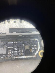

Oppo a12 Ayaw mag charge sabi nang tumer nakidlatan daw while charging.
Sunog yung charging board kaya try ko change charging board but no luck pa rin
Solution B

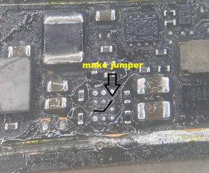

Tanggal yung maliit na IC at make jumper
Procedure pic :

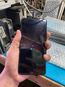

Done!!!​
