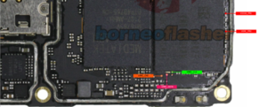

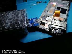

-Disassemble the unit to make pin out
-Connect Clk,Data,Cmd and Ground just use charger for Vcc and Vccq

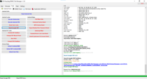

-Open Easy jtag connect Emmc Filemanager v1.22
-Click Connect to Easy Jtag and goto Tools Tab
-Select Reset Google Frp
Wait and Done
