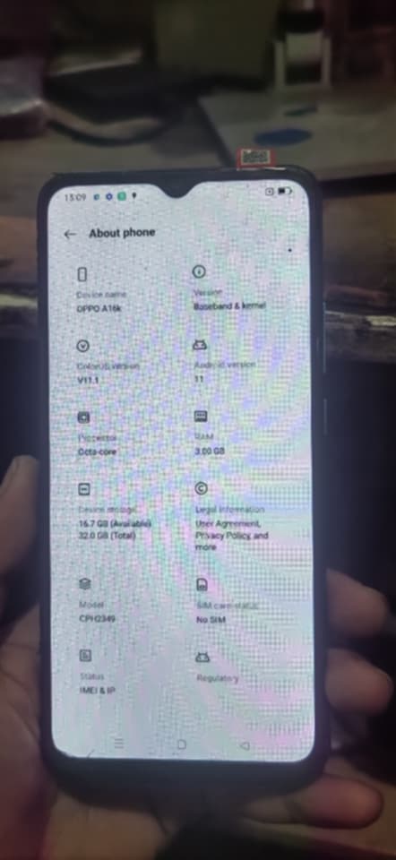

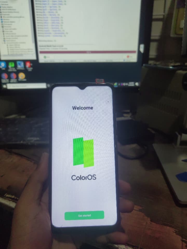

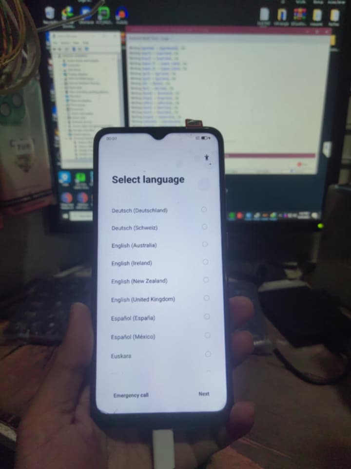

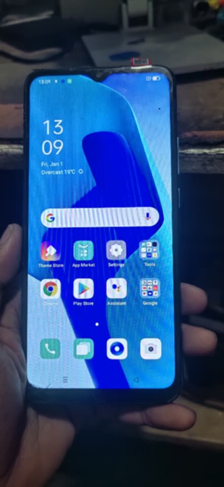

Oppo A16K - Unbootable BlackScreen of Death - Done (AMT) Flashing
- Open AMT Tool
- Select Brand & Model
- Select Function Flashing
- Off unit, Hold vol up & down (Bootkeys To Detect Comport)
- wait matapos flashing...
- Done and pera na
>> Firmware
A16KGSMFOJITEAM786
i just want to say thank you sa owner ng Firmware link na gamit ko ;)​

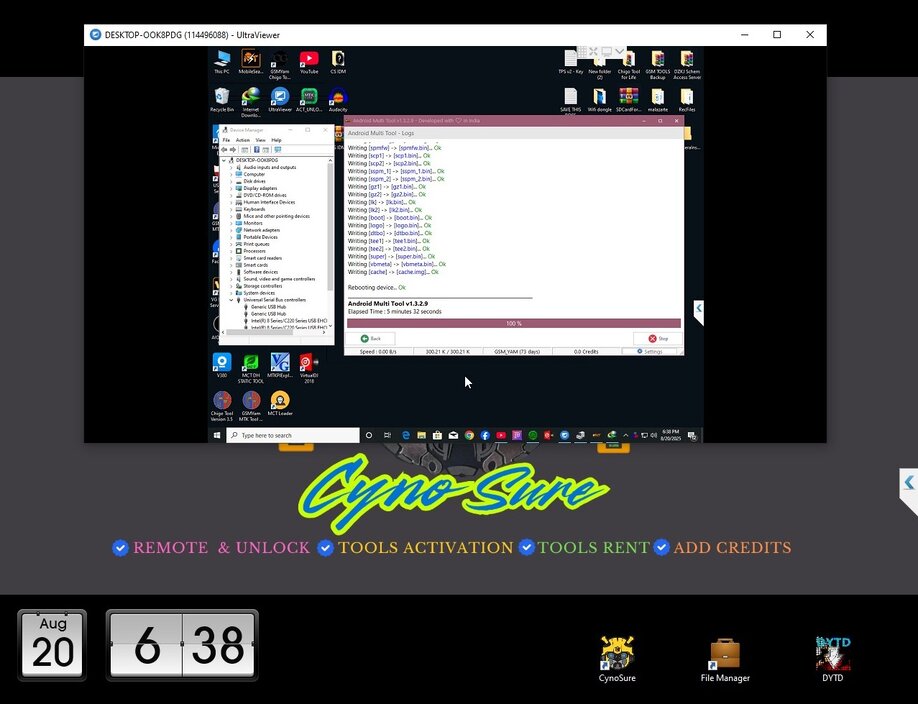

Logs:
Brand : OPPO
Model : A16K
Operation : Flash
Searching for usb device... Found
MediaTek USB Port (COM4)
Connecting to device...Ok
ChipId : MT6765 [Helio P35/G35], SW Ver : 0000, HW Ver : CA00
Exploiting device for BROM access... Ok
Sending Download-Agent to device... Ok
Authorizing device for operations... Ok
Reading partition information... Ok [128]
Reading system information...
Chipset Type : arm64-v8a
Security Patch : 2024-02-05
Build Date : Thu Mar 27 16:58:12 CST 2025
Build Number : RP1A.200720.011 release-keys
Incremental : 1725938230840
Device Model : oplus_mssi_64_cn
SDK Version : 30
Device Brand : alps
Android Ver : 11
Rebuilding partition table... Ok
Formatting desired partition... Ok
Writing [preloader] -> [preloader_oppo6765.bin]... Ok
Writing [preloader_backup] -> [preloader_oppo6765.bin]... Ok
Writing [recovery] -> [recovery.bin]... Ok
Writing [vbmeta_system] -> [vbmeta_system.bin]... Ok
Writing [vbmeta_vendor] -> [vbmeta_vendor.bin]... Ok
Writing [metadata] -> [metadata.bin]... Ok
Writing [cdt_engineering] -> [cdt_engineering.bin]... Ok
Writing [md1img] -> [md1img.bin]... Ok
Writing [spmfw] -> [spmfw.bin]... Ok
Writing [scp1] -> [scp1.bin]... Ok
Writing [scp2] -> [scp2.bin]... Ok
Writing [sspm_1] -> [sspm_1.bin]... Ok
Writing [sspm_2] -> [sspm_2.bin]... Ok
Writing [gz1] -> [gz1.bin]... Ok
Writing [gz2] -> [gz2.bin]... Ok
Writing [lk] -> [lk.bin]... Ok
Writing [lk2] -> [lk2.bin]... Ok
Writing [boot] -> [boot.bin]... Ok
Writing [logo] -> [logo.bin]... Ok
Writing [dtbo] -> [dtbo.bin]... Ok
Writing [tee1] -> [tee1.bin]... Ok
Writing [tee2] -> [tee2.bin]... Ok
Writing [super] -> [super.bin]... Ok
Writing [vbmeta] -> [vbmeta.bin]... Ok
Writing [cache] -> [cache.img]... Ok
Rebooting device... Ok
Android Multi Tool v1.3.2.9
Elapsed Time : 5 minutes 32 seconds
