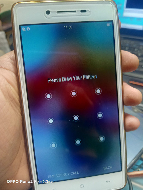

Hello po sa inyong lahat. Today may tanggap po ako oppo a33 pattern problem
As customer said na kung pwede daw sana walang mabura then sabi ko try ko at hindi naman ako nabigo.

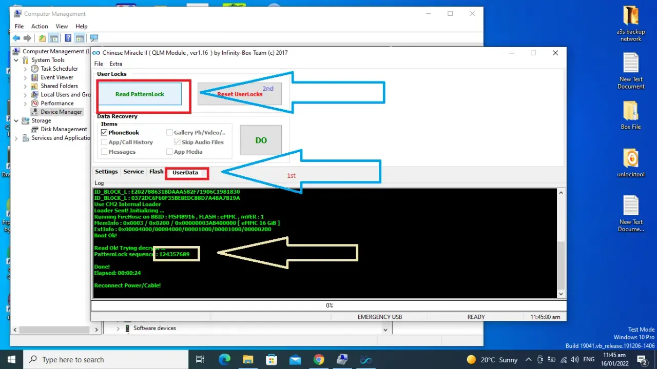

Open cm2 qualcomm and click 'Userdata' then 2nd click 'Read Patternlock' now turn off device and hold volume up and down and insert usb cable

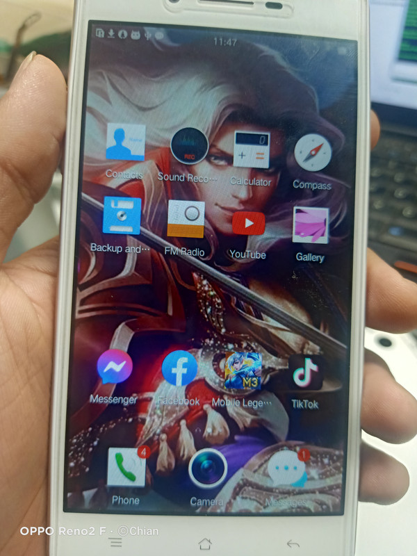

At heto naman po ang proof ko
