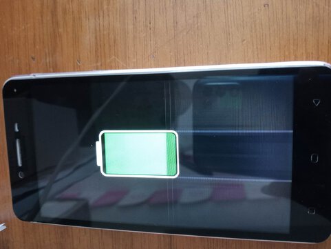

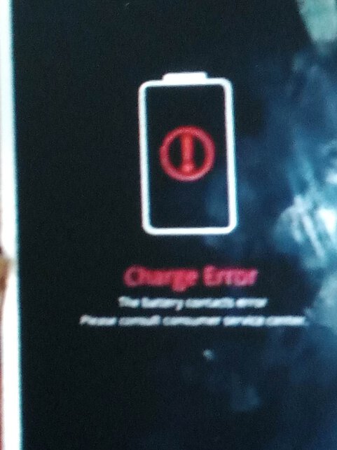

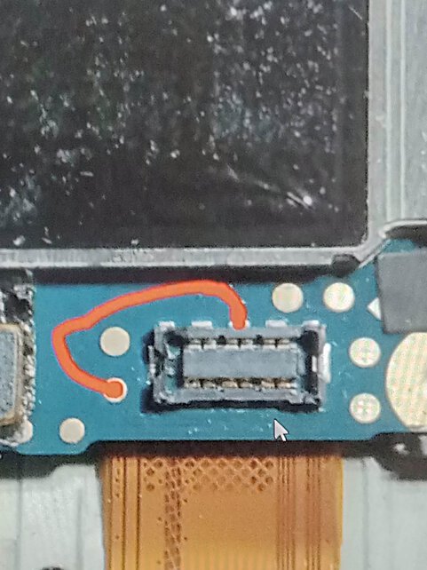

jumper po gamit ng jumper wire sa may battery connector

sa pic boss tingin ko bsi or btemp. the one who control charging system kung puno na or btemp naman sa battery temperature? correct me if im wrongPaki info ano jumper mo sir. ? Positive line or ground.
tama..sa pic boss tingin ko bsi or btemp. the one who control charging system kung puno na or btemp naman sa battery temperature? correct me if im wrong
Legit bossjumper po gamit ng jumper wire sa may battery connector

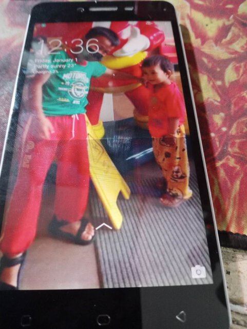

done master legit 100%jumper po gamit ng jumper wire sa may battery connector
