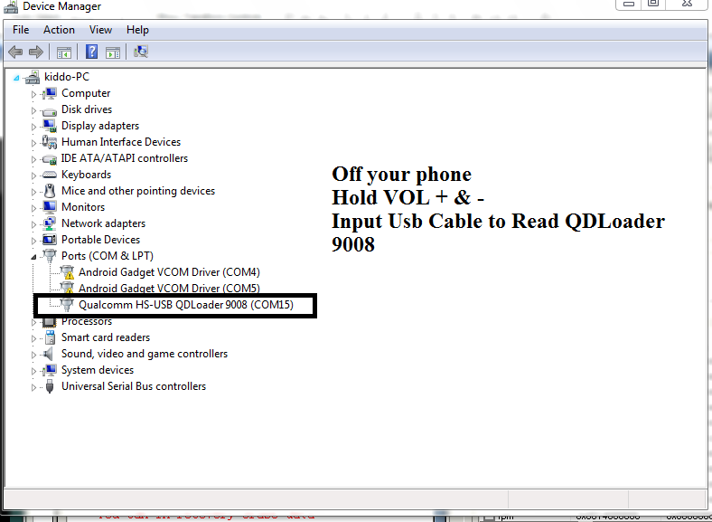

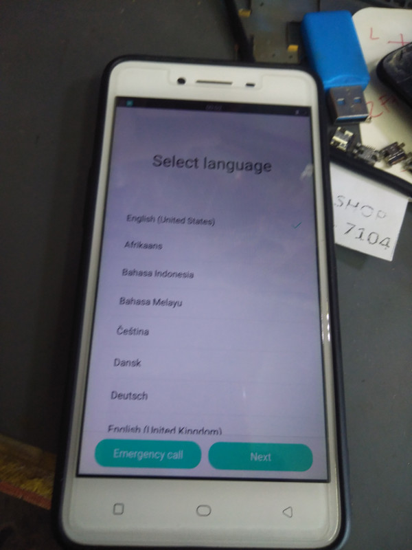

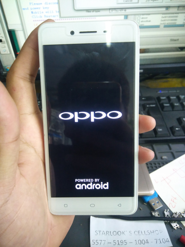

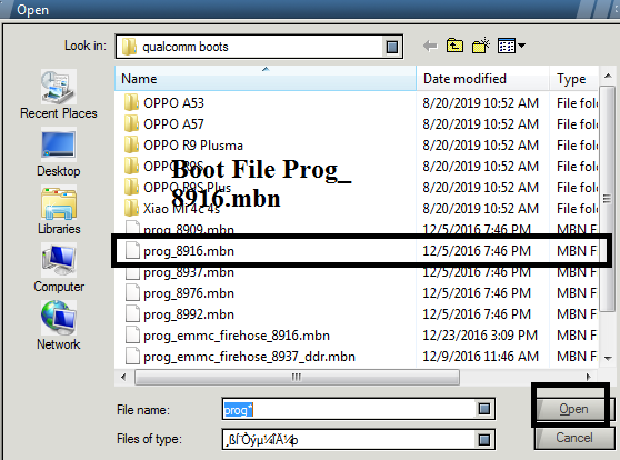

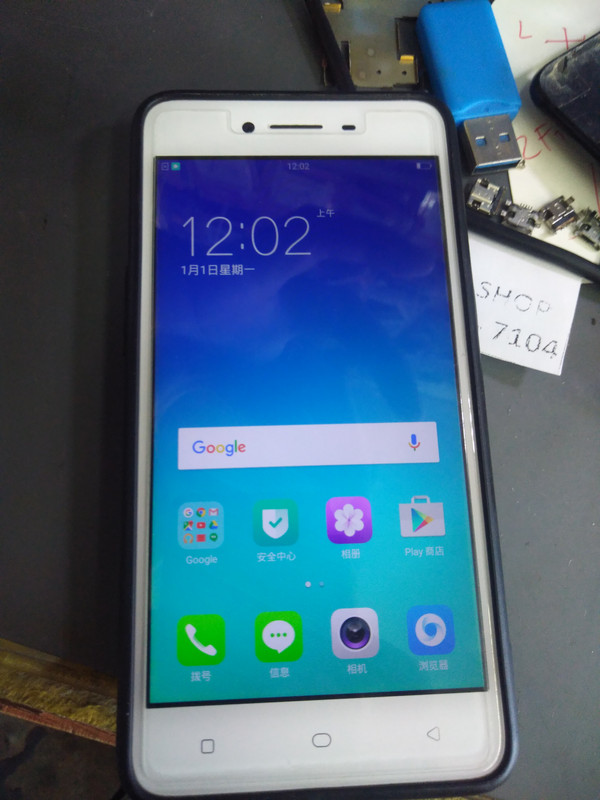

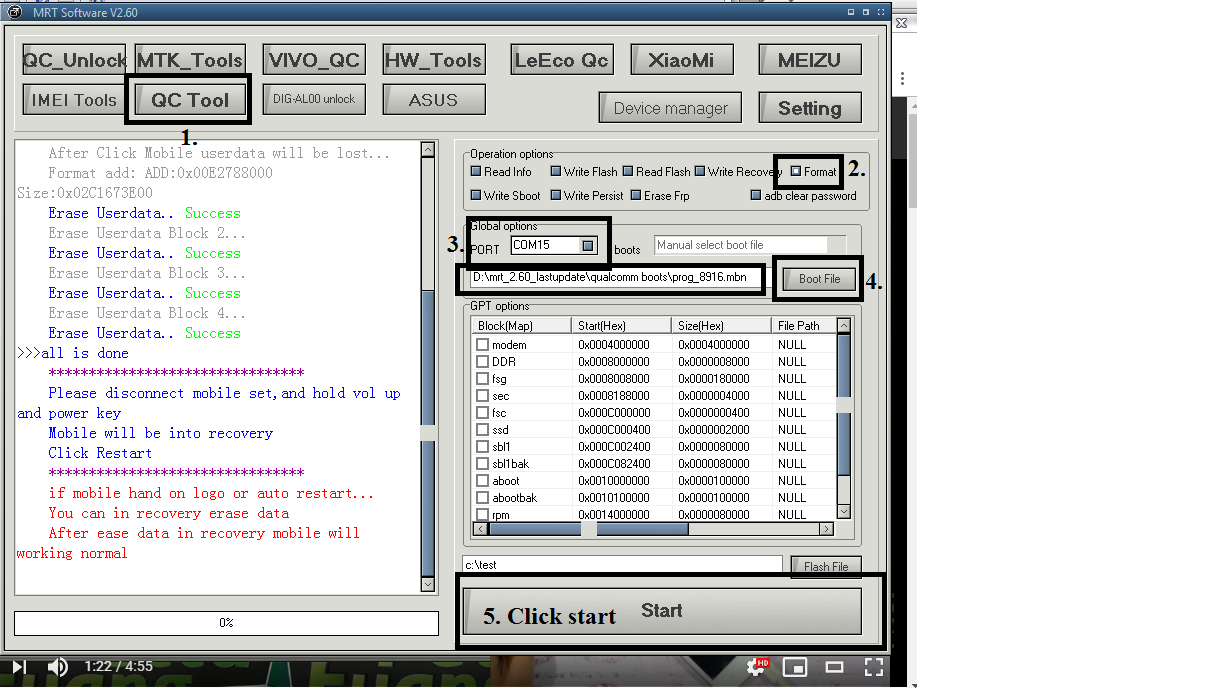

Gsmkiddo22 Registered Joined Apr 13, 2019 Messages 243 Reaction score 461 Points 341 Location San Rafael Bulacan Oct 9, 2019 #1 Oppo A37 Passcode/Pattern Problem Solve kay MRT. Sa mga walang Cm2QLC AT NCKQLC Baka makatulong po sir Tools MRT USB CABLE Para sa FRP *#812# DIAL Or wait nyo automatic naman yan. Sana po maka help sa #Bulacan Chapter #AntGSM starlooks Cellshop #KeepOnSharingParaDiMawalaSB GODBLESS
Phonejav2019 Registered Joined Mar 1, 2019 Messages 215 Reaction score 55 Points 1 Location Pob. District 2, MacArthur Leyte Nov 23, 2019 #2 >>>>Auto search Mobile port... >>>Try connect to mobile...Fail connect timeout,Please try into 9008 devices...

robertconner01 Registered Joined Mar 5, 2016 Messages 157 Reaction score 35 Points 201 Location Poblacion Cordova Cebu City Nov 28, 2020 #5 fixion said: >>>>Auto search Mobile port... >>>Try connect to mobile...Fail connect timeout,Please try into 9008 devices... Click to expand... same sakin
Phonejav2019 Registered Joined Mar 1, 2019 Messages 215 Reaction score 55 Points 1 Location Pob. District 2, MacArthur Leyte Nov 29, 2020 #6 robertconner01 said: same sakin Click to expand... try mo smart key tool crack from gsmxtm
