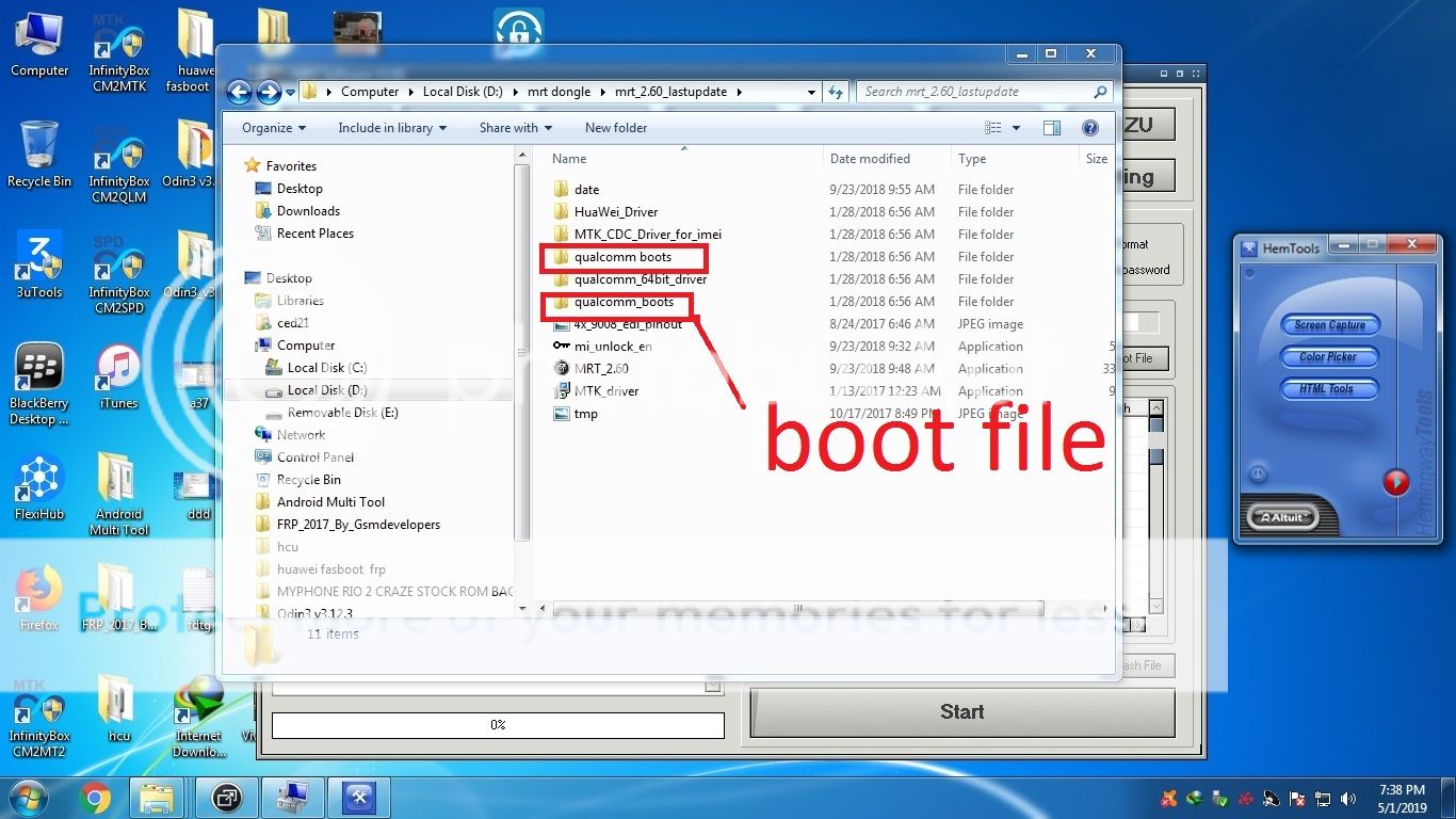

at ang driver na gagamitin ay driver qualcom mismo na nakalagay sa mrt dongle pag ok na

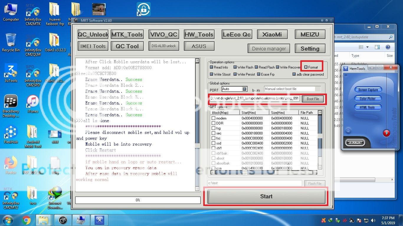

open mrt dongle
click qc tool
click format
click boot file hanapin si prog 8916 nasa mrt dongle file
then start hintayin hangang matapos
