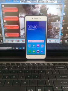

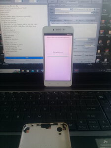

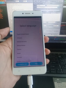

SHARE KO LANG SA NAKAKA ALAM NA AT SA MGA BAGUHAN
UNIT STATUS PASWORD
DONE .
VIA MIRACLE THUNDER CRACK
BOOTH KEYS HOLD VOLUME UP AND VOLUME DOWN.
OPEN MC CRACK
SELECT Qualcom
Brand: Universal
Model: Universal OPPO Method
select Factory Reset ( Shafe Mode )
Hold Boothkeys
insert usb cord to mobile phone
click (Port)
pag nagpakita si COM5 Qualcomm HS-USB QDLoader9008
it means detect ang unit.
then hit Start Button wait until Being Format and done.
for FRP go to emergency dial (*#813#)
thanks its refferences Only;)​
