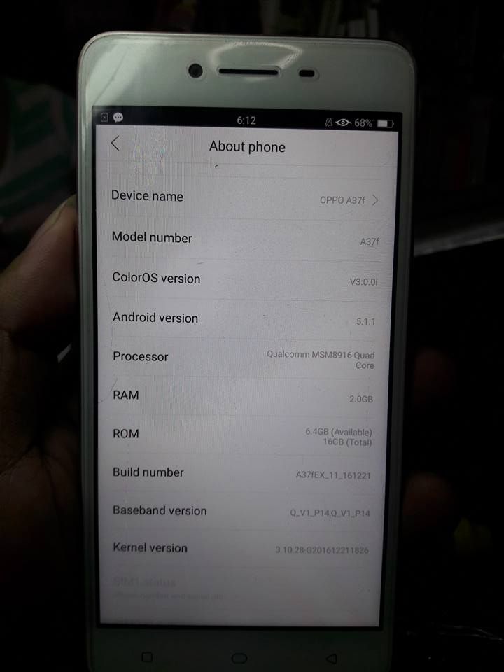

Unit: OPPO
Model: A37f
Chipset: Qualcomm

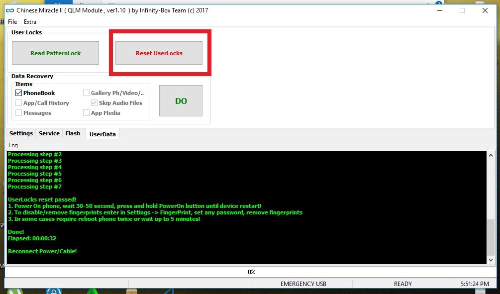

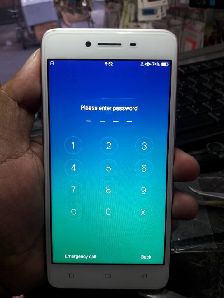

Problem: Password
1st Solution: Hard Reset no luck!
2nd Solution: Update via SD Card no luck!
3rd Solution: use CM2QLM then RESET UserLocks

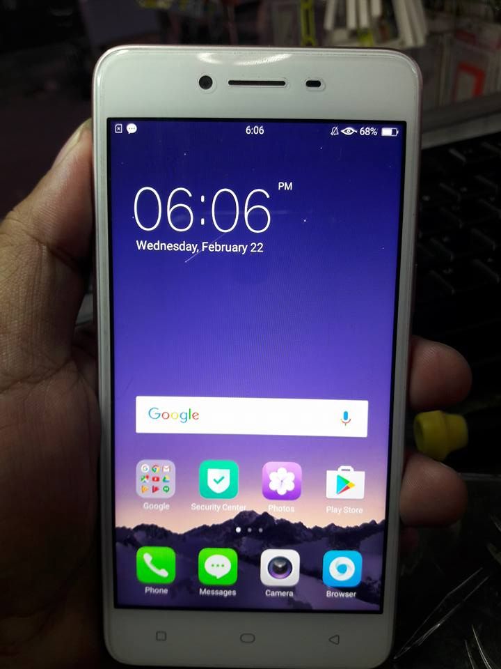

:D Big SMILE and DONE!!!

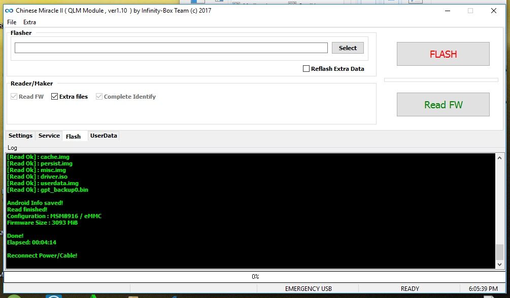

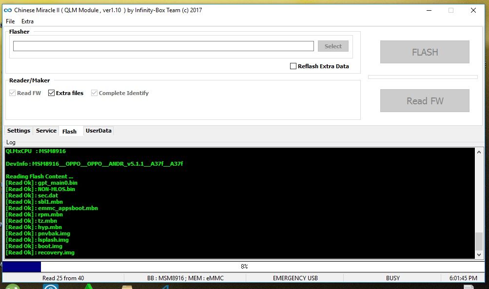

then ready to Backup baka may mangailangan....(l:0
DONE!!!:D:D:D
Backup Firmware: https://www.mediafire.com/?bzmbt5k0nn6t344
NOTE: Pasword Protected po yan.. thanks button sapat na!!!! salamat!!!
