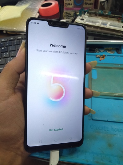

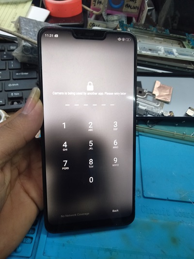

REFERENCE OPPO A3S (CPH-1853) PASS & FRP DONE VIA JTAG
KhenZrha27
Aug 6, 2017
620
49
81
Mariveles,Bataan
SHARE OPPO A3S (CPH-1853
ACTION TAKEN

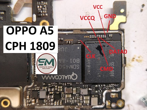

KALAS AT PINOUTS
CPH-1853 PINOUTS
FOLLOW NUMBER PROCEDURE

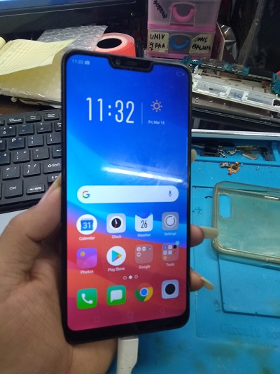

DONE A3S HANGGANG SA MULI
NAWAY MAKATULONG SA LAHAT​

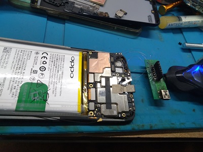

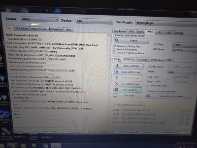

master ask kulang po kc bumele ako bagong easy jtag plus makakaditik cya sa a3s na clear pin & frp clear ang prob hang nalang..napansin ko walang reset oppo.....at saka ver.3.6.1.2 lang sa akin....pwd nyo po ba mapaliwanag kc nanebago po ako....tnx po
BOOT TO RECOVERY MO BOSS AT WIPE DATA MO
PAG FAILED KINALABASAN NEED PA REPAIR FILE
GANYAN DIN NGYARE SA TANGGAP KO NOW HINANAPAN KOPA NG SULOSYON
ETO SOFTWARE PRA LUMABAS RESET OPPO
https://smartjtagbox.com/owncloud/i...7m0gluznsD04WXgz6IuHAdtcbSAxcUvdNX6fV5Cb6j9uM
ganyan den sa akin failed na cya kaya dinala kuna sa ibang shop saglit lang nagawa na tinanong ko ang procedure pro hnd cnasabe walang solfware kunde sa jtag paren......slamat bos sa pag sagot at installer..yang prob ang pinag tataka ko paano ginawa sana magawa na sayo
nka gawa na tropa ko nyan after wipe restart na lang at failed sa recovery wipe. kya ginawa nya flash nya using easy jtag uncheck lahat bukod sa "cache" and "userdata" kaso ayaw ibigay ung file at ung video na procedure.
