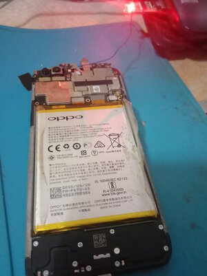

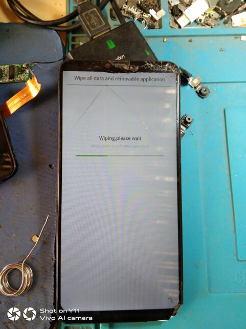

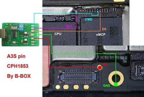

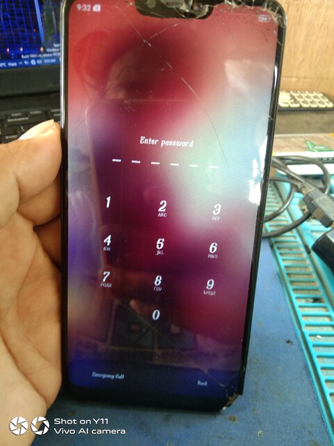

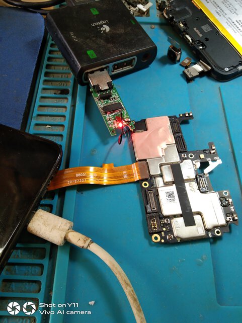

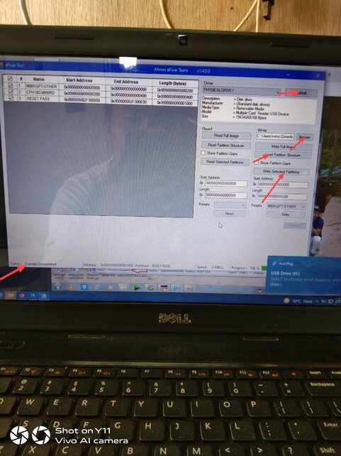

oppo a3s[cph1853]password done by emmc isp via eFixer Tool tested 100%
1.eMMC ISP Connect Device https://www.mediafire.com/file/seqtzttwvvs03kf/OPPO_A3s_%26_A5_2020_%26_A7_eFixer_Tool.rar/file

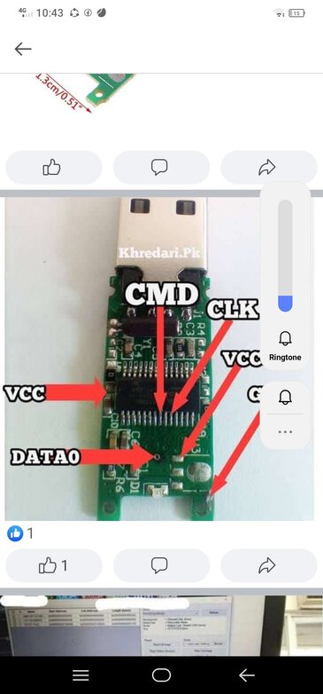

clk cmd data0 gnd insert charger
2.Open eFixer Tool.exe
3.Browse BIN File
4.Click Load Partition Structure
5.Then Click Write Selected Partiion
Done Process Completed

View attachment 4650View attachment 4645View attachment 4645

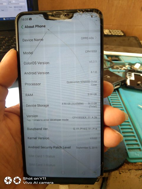

may bin file ka nito boss?
my signal?
ung sakin pgkatapos walang signal
no service na

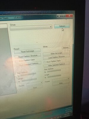

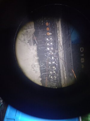

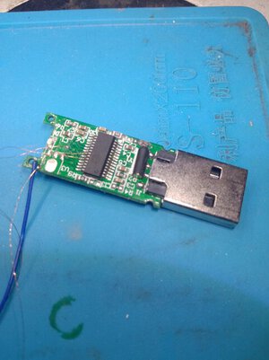

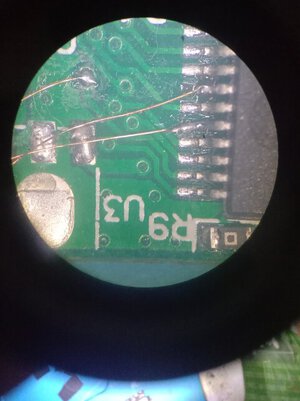

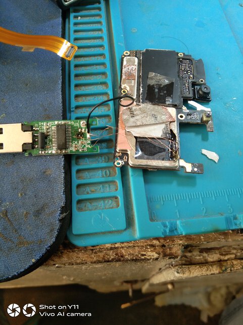

Bakit sakin boss ayaw talagaag diteck anu kaya posible kulang ilan besis kuanarin ininang at nag palit ng wire. Para sa isp no pin out

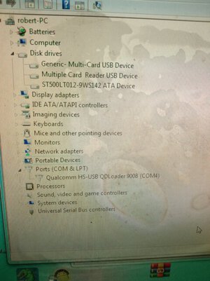

un isntall mo driver nya sir. install ulit or update.
Subukan ko sir. Sabagay walaman ako na in install na driver pa saksak ko sa usb kusa nalang lumabas yung driver niya. Update ako sir oag nasubukan kona sugest mo thanksss...
Same lang din sir negative po. Ayaw din po magresponse sa software diparin nababasa ang emmc.

Good day.! saan tayo mka bili ng dongle pang remove pin for a3s master?

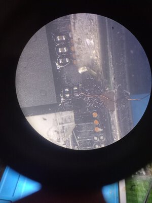

Sakin nag detect na nong niliitan ko yong wire jumper sa clk,cmd data0
