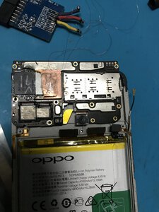

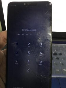

Unit Oppo A3s 4/64 Variant password issue pasensya npo 1st time ko lang mag post

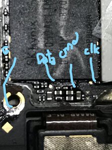

Action taken: Baklas unit tuklapin ang shield at e hinang gnd data cmd clk
Ung supply ng vcc at vccq salpak nyo lang usb, hang lcd fpc connector at battery
Connect hinang sa 1 bit isp rev 2.1 adapter easy jtag plus
Action 2 run software tool interface Emmc tool suite ver. 1.6.6.0
Voltage 2.6v, Interface easyjtag2/ISP method, Frequency 24 Mhz
Backup muna rom 1 1Gb rom 2 4gb rom 3 4gb para po incase may back kayo
Pag tapos backup run easy jtag tool 3.8.0 click reset oppo ganun lang ka simple
Hindi nko nag update firmware ng emmc kc wala buget si tumer kaya password lang tinggal ko salamat

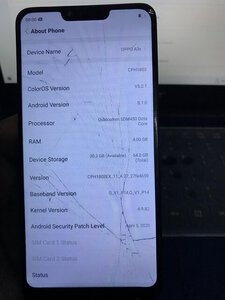

Get firmware version
Manufacturer = OPPO
CPU Abi = arm64-v8a
Android release = 8.1.0
Security Patch = 2020-04-05
Brand = OPPO
Device = PBAM00
Model = PBAM00
Firmware version = PBAM00_11_A.27
Firmware date = Tue Apr 7 23:03:18 CST 2020
Eto naman ung pag tanggal ng password click reset oppo sa easy jtag tool 3.8..0
CMD Pullup Level:2115 mV
CMD Active Level:2269 mV
Box IO Level:2600 mV
CLK Rate:24000 kHz
Bus Width:1bit,SDR
HiPower mode is off!
---------- eMMC Device Information ----------
eMMC CID : 90014A484347386134A52B71898355E7
eMMC CSD : D02701328F5903FFFFFFFFEF8A400027
eMMC Manufacturer ID: 0090 , OEM ID: 014A
eMMC Date: 05/2018 Rev.0xA5
eMMC NAME: HCG8a4 , S/N: 728861059
eMMC NAME (HEX): 484347386134
EMMC ROM1 (Main User Data) Capacity: 59640 MB , 0x747C000 pages , 0xE8F800000 bytes
EMMC ROM2 (Boot Partition 1) Capacity: 4096 kB
EMMC ROM3 (Boot Partition 2) Capacity: 4096 kB
EMMC RPMB (Replay Protected Memory Block) Capacity: 4096 kB
EMMC RPMB is programmed and written 163414 times
EMMC Permanent Write Protection: No
EMMC Temporary Write Protection: No
EMMC Password Locked: No
Extended CSD rev 1.8 (MMC 5.1)
Boot configuration [PARTITION_CONFIG: 0x38] Boot from:ROM1 (Main User Area)
Boot bus config [177]: 0x00 , width 1bit , Partition config [179]: 0x38.
H/W reset function [RST_N_FUNCTION]: 0x01
High-capacity WP group size [HC_WP_GRP_SIZE: 0x00004000]
Partitioning Support [PARTITIONING_SUPPORT]: 0x07
Device support partitioning feature
Device can have enhanced tech.
Partitioning Setting [PARTITION_SETTING_COMPLETED]: 0x00
Writing Recovery Command to MISC
Done.
emergency dial *#813# para deretso na sa menu
