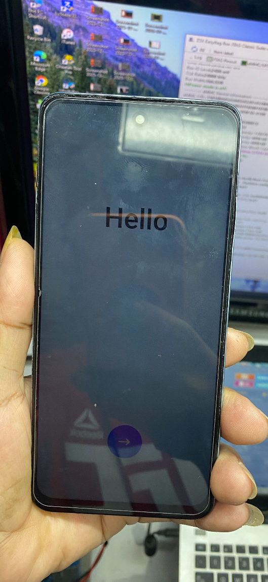

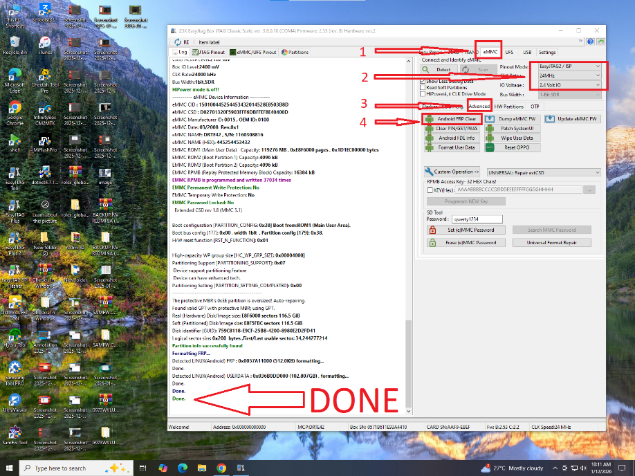

OPPO A3X ANDROID 15 FRP PROBLEM NEGA SA UNLOCKTOOL AT HYDRA TOOL DONE TO MY EASY JTAG PLUS
PROCEDURE

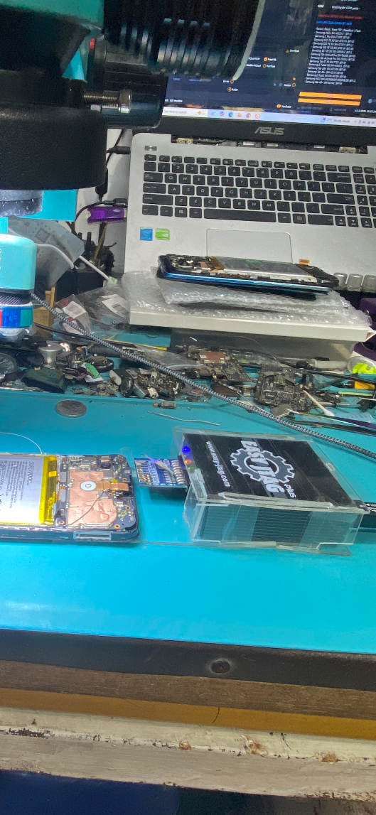

FIRST- DISASSEMBLE UNIT

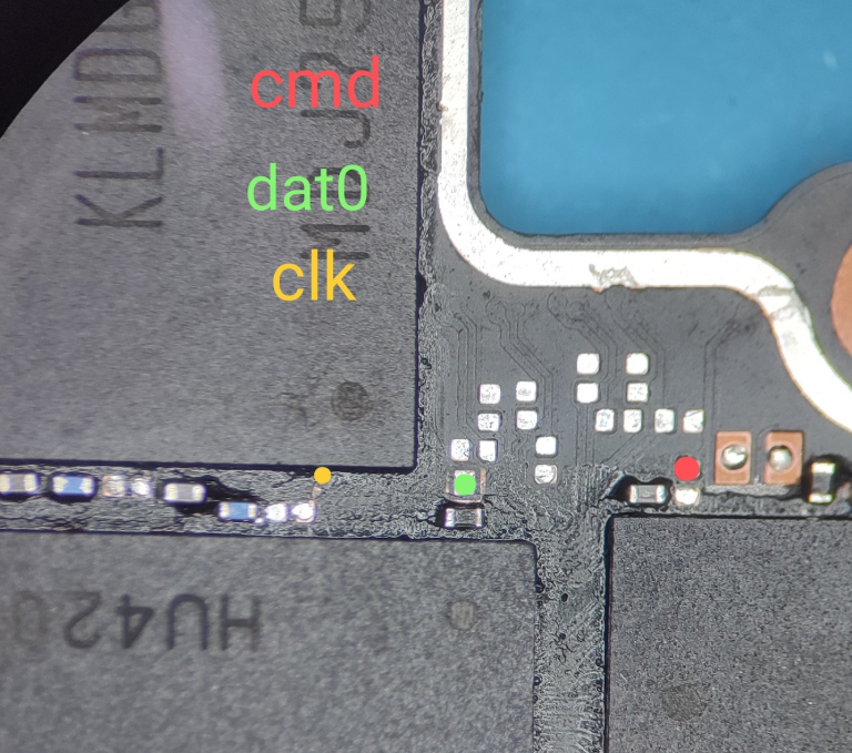

2STEP-CONNECT ISP PIN OUT TO EMMC ADUPTOR
3STEP-OPEN EASY JTAG TOOL CLASSIC SUITE VER.3.8.0.10
4STEP-FOLLOW THE IMAGE FOR SUCCESS PROCEDURE

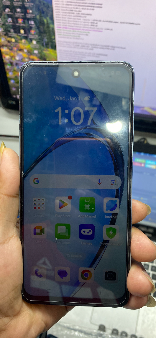

MY FINNISH PRODUCT
DONE​
