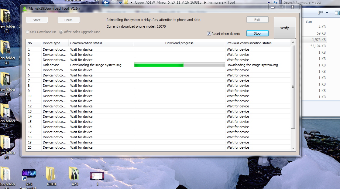

Action taken:
download this
https://firmwarefile.com/oppo-a51w-mirror-5
how to connect:
RUN Msm8x39DownloadTool.exe
SELECT 15070 MODEL
CHECK RESET WHEN DOWNLOAD

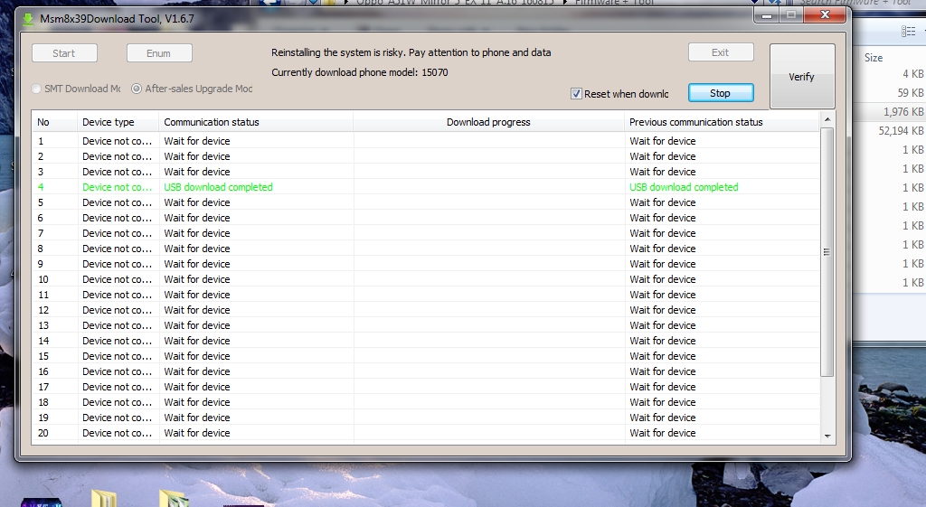

AFTER FLASH
CLICK START
HOLD VOLUME UP INSERT USB WAIT FOR DONE

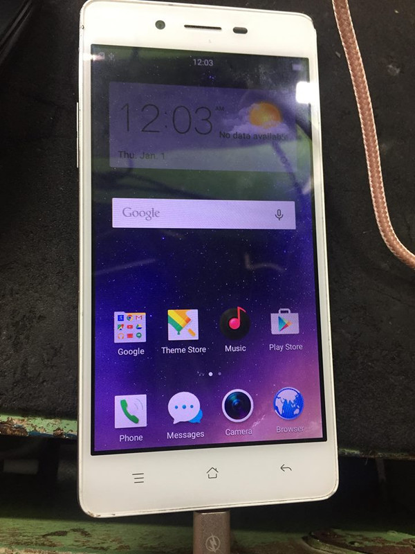

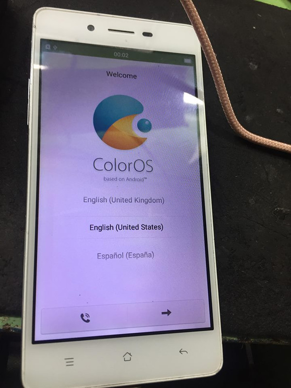

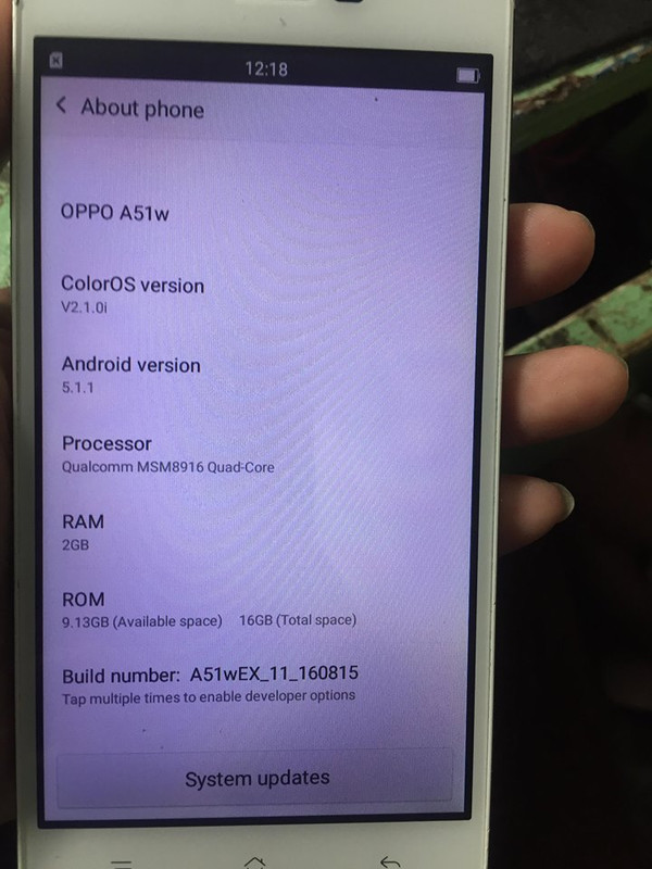

ito po yung logs:
ito na po yung finish product:
salamat po
