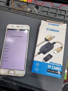

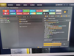

MAY TANGAP PO AKO OPPO A57 HANG ON LOGO LANG INALIS KO NA RESISTOR SA BATTERY PERO GANUN PADIN. SO TINRY KO IRESET VIA UNLOCKTOOL THEN NAG OK NAMAN PO SYA. GINAMITAN KO NALANG NG HARMONY PARA WALA NAKO TESTPOINT PO.
