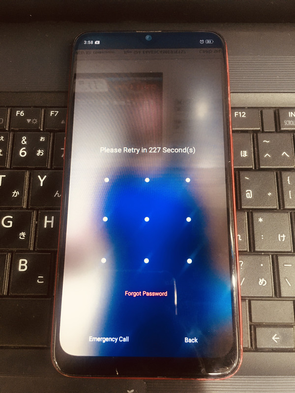

Sira ang volume flex kaya ayaw mag connect kay MRT.

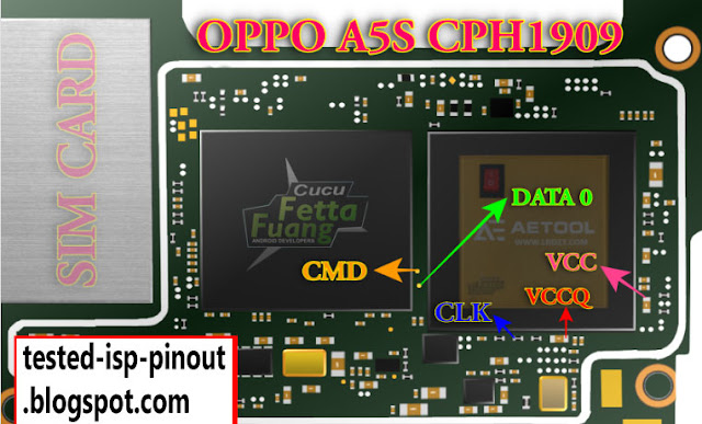

Connect CLK,CMD,DAT0 at GROUND sa pinout
Remove battery and insert usb cable para sa supply
Connect ISP sa box

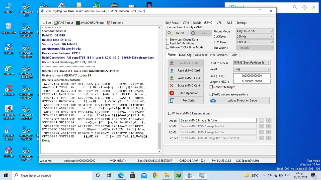

Open EASY JTAG CLASSIC SUITE
Select OPPO A5s
Go to EMMC
Click DETECT
Click RESET OPPO, pero nag failed sya, 3x ko inulit pero failed pa rin.

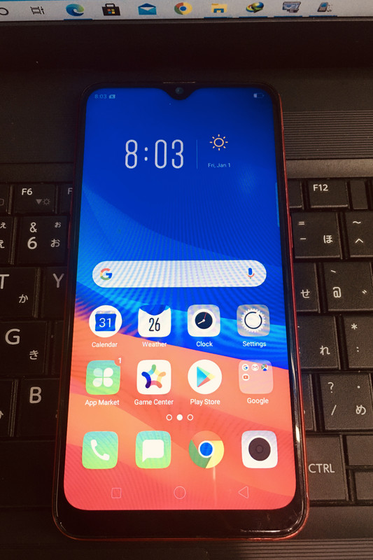

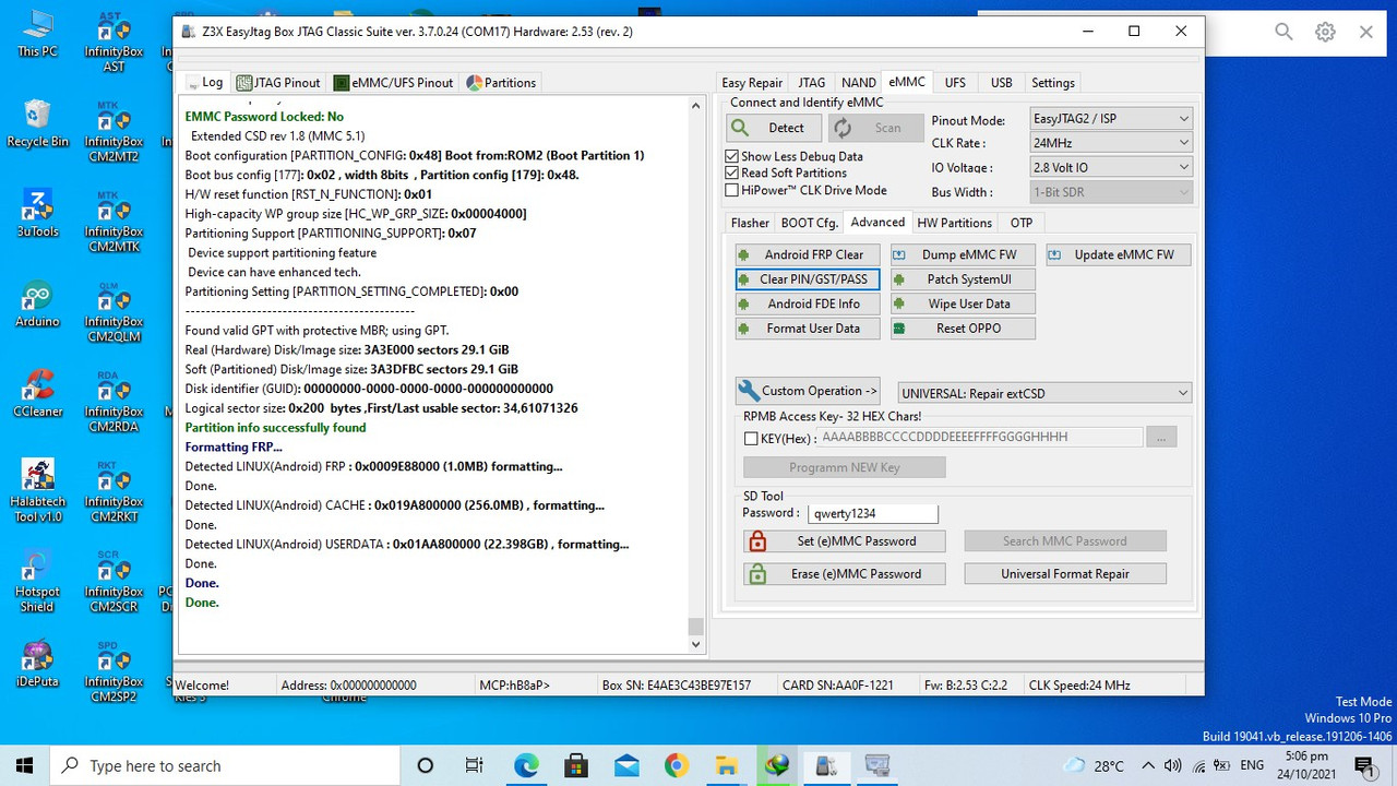

Kaya nag WIPE USER DATA ako at ANDROID FRP CLEAR
DONE.
Para sa FRP dial *#813#
