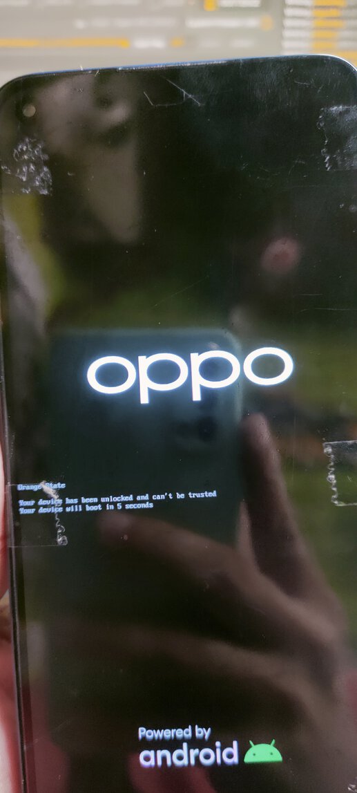

E ELOY_TECH Registered Joined May 11, 2021 Messages 31 Reaction score 29 Points 51 Location Muntinlupa CITY Apr 20, 2023 #1 Oppo a55 after ma flash sa unlock tool..any solution mga bossing
microtech249 Registered Joined Apr 12, 2018 Messages 710 Reaction score 364 Points 81 Location kalamansig,sultan kudarat Apr 20, 2023 #2 ELOY_TECH said: View attachment 21865View attachment 21865 Oppo a55 after ma flash sa unlock tool..any solution mga bossing Click to expand... relock bootloader boss..........
Yongitechz Registered Joined Jun 28, 2014 Messages 590 Reaction score 73 Points 81 Location Panabo City,Davao del Norte Apr 20, 2023 #3 relock mo boatloader sir
E ELOY_TECH Registered Joined May 11, 2021 Messages 31 Reaction score 29 Points 51 Location Muntinlupa CITY Apr 20, 2023 #4 THANK YOU BOSSING OK NA AFTER RELOCK BOOTLOADER
