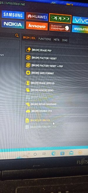

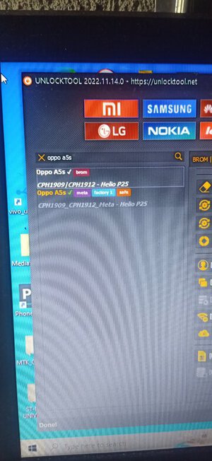

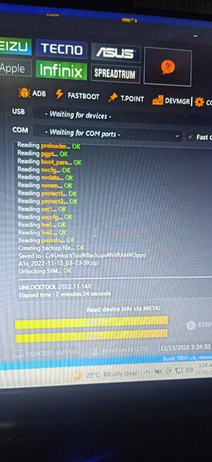

open unlocktool
click oppo tab
click oppo a5s(brom)
select(brom/edl)
then click (brom)Sim Unlock
off unit
hold volume up & down
and connect usb cable
wait nlng po matapos

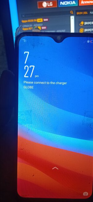

nilagyan ko ng globe simcard at
inopen ko data at gumana nmn

advice mo lang po boss sa costumer na temporary unlock lang po un,,after restart or nalobat balik sa lock un..
