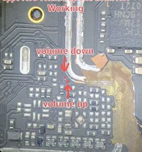

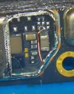

REFERENCE oppo A5s Volume down [way]
bladeknight
Jun 13, 2014
156
11
santiago city
model: oppo a5s
problem: volume down [password]
solution: jumper
tested po yan.
hindi ko lang na picturan ang unit..
