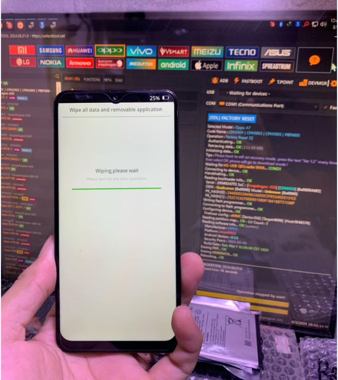

Good Day mga idol share kulang to Oppo A7 password na dali ni UnlockTool

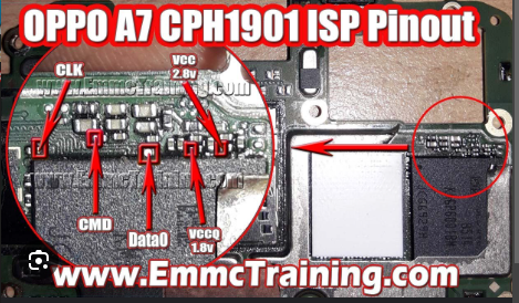

Nag try ako sa Thread ni sir kaso ayaw pumasok sa EDL https://pinoytechnician.com/threads/oppo-a7-password-and-frp.238265/
Kaya na isip ko testpoint at yun nadali, testpoint sa Data0 mga idol
Open UnlockTool
Select Oppo
Select A7 Model
Click factory Reset
TP and Conect to pc
Done
