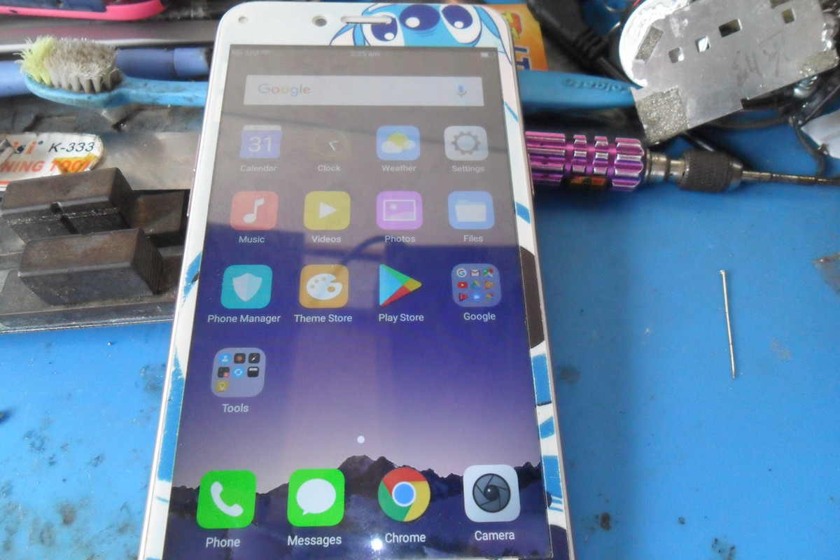

Oppo A71 CPH1801 passcode done sa MRT
PROBLEM:
PASSCODE

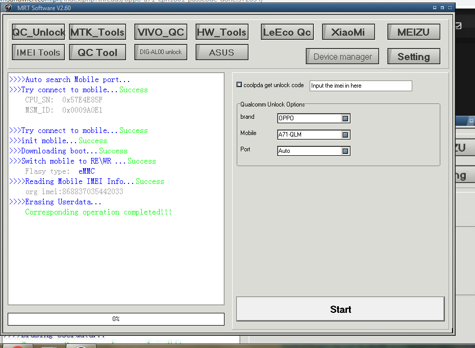

PROCEDURE:
OPEN MRT
QC_UNLOCK
CHOOSE A71-QLM
PRESS VOL UP & DOWN
THEN PRESS START
after format pag naka FRP SUNDAN NYO LANG TO
MIRON DIN DIAL TRICKS SA FRP PUNTA KAYO SA EMERGENCY DIAL DIN DIAL LANG PO NG *#812# LUMABAS SI ERASE EVERYTHING DIN CLICK OK
DIN MAG AUTO RESTART PO SYA DIN SMILE,,
