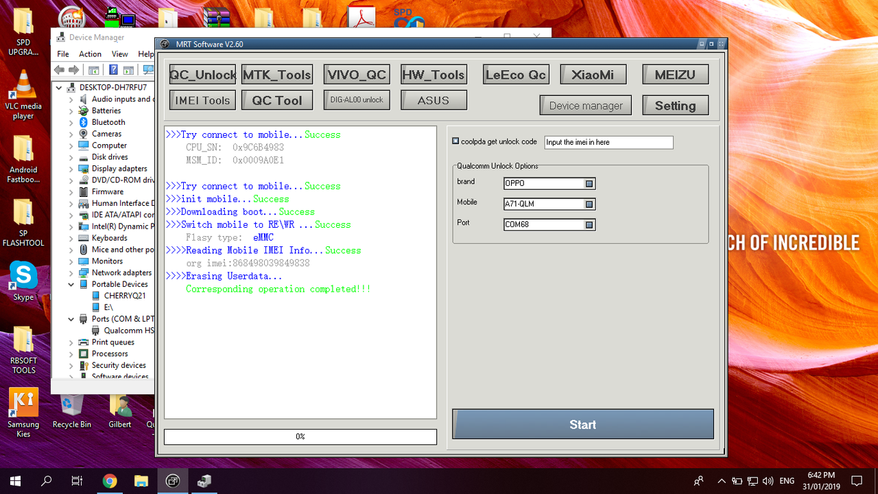

gilbert vigo Expired Account Joined Jul 15, 2014 Messages 166 Reaction score 132 Points 231 Location montalban rizal Jan 31, 2019 #1 OPPO A71 CPH1801 password done by MRT 1 open MRT 2 click QC UNLOCK 3 select brand oppo 4 select mobile A71_QLM 5 power off pone 6 hold vol. UP&DOWN 7 salpak usb 8 click start hintayin matapos... THANKS... hindi na na picturan yong unit nag mamadali na si tomer Last edited by a moderator: Feb 6, 2019
