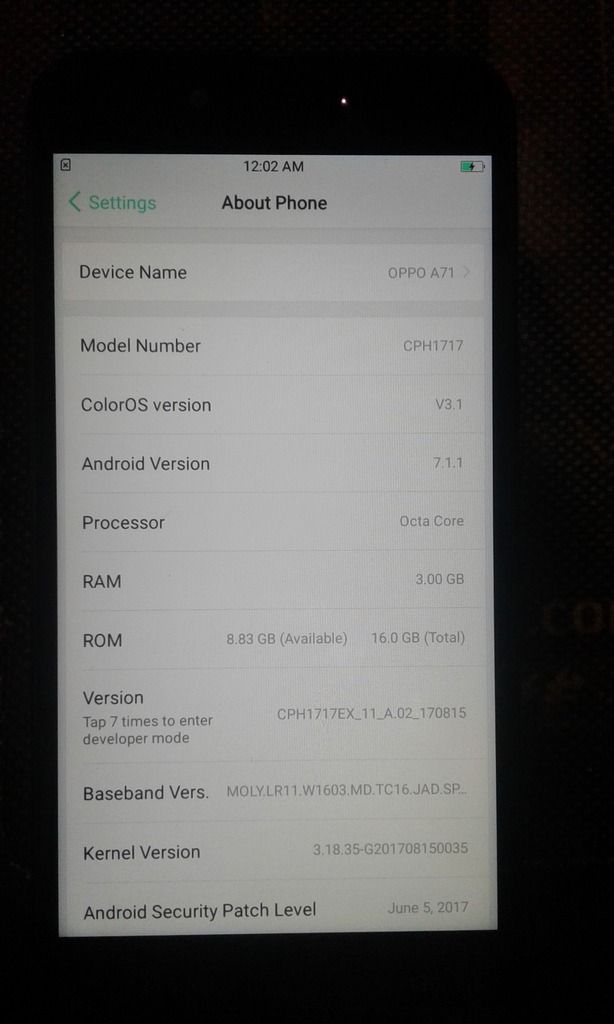

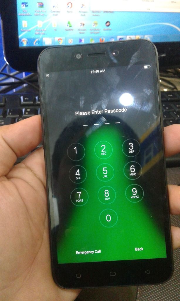

Unit: Oppo A71 CPH1717
Problem: Pascode
hard reset , pero naghingi rin ng phonelock/passcode.

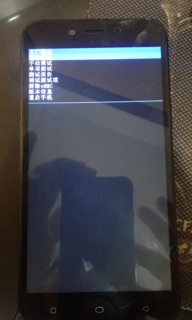

Solution: tirahin natin sa NCK crack, open nck crack go to service,click reboot phone
select factory reboot and click reboot phone in selected mode.
hold volume up and down and connect phone to pc.
hintayin lang na lumabas yellow text sa screen
scroll down to eMMC click power button​

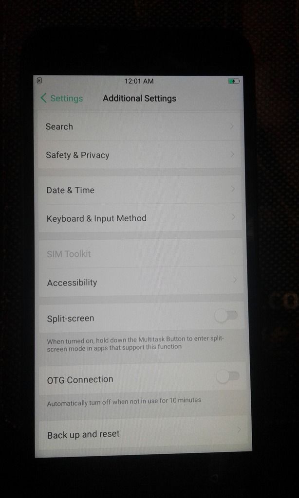

After matanggal passcode

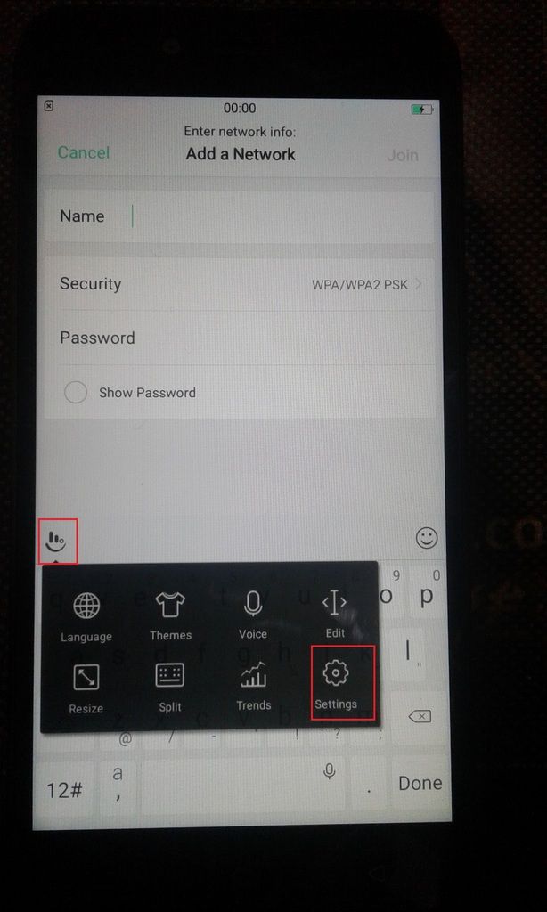

naka FRP lock pa
huwag lang econnect sa wifi ang phone
click add network
tapos may lalabas na sign
click lang ang finger sign

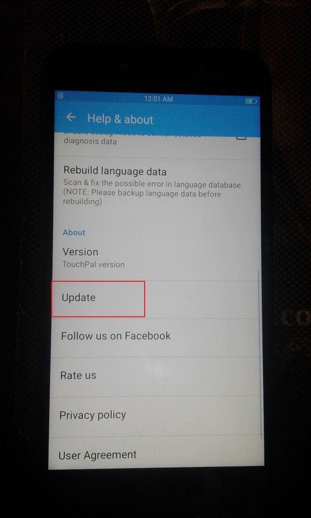

click settings

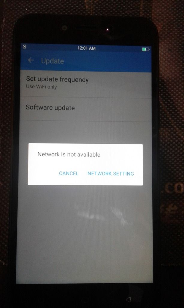

click update
click software update next network settings

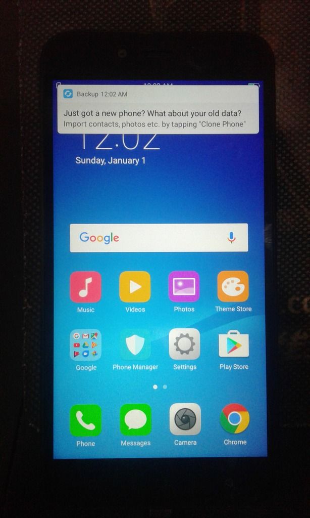

papasok na yan sa settings ng phone
hanapin lang ang back up and reset
SANA PO MAKATULONG
