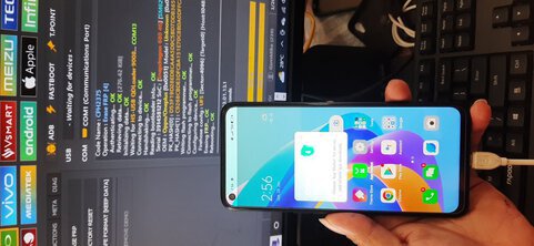

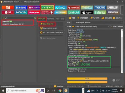

WESTlee_21 Moderator Staff member Joined Jun 22, 2021 Messages 544 Reaction score 510 Points 121 Location lapaz,tarlac Feb 15, 2023 #1 Oppo A76 CPH2375 FRP VIA Unlocktools procedure: open unlocktool, select Oppo search and select model oppo a76 click [EDL] erase FRP press vol. up and down, and ansert cable.....
