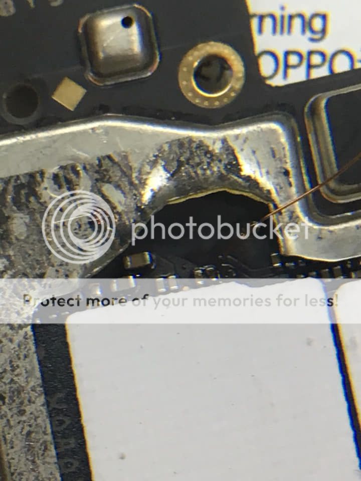

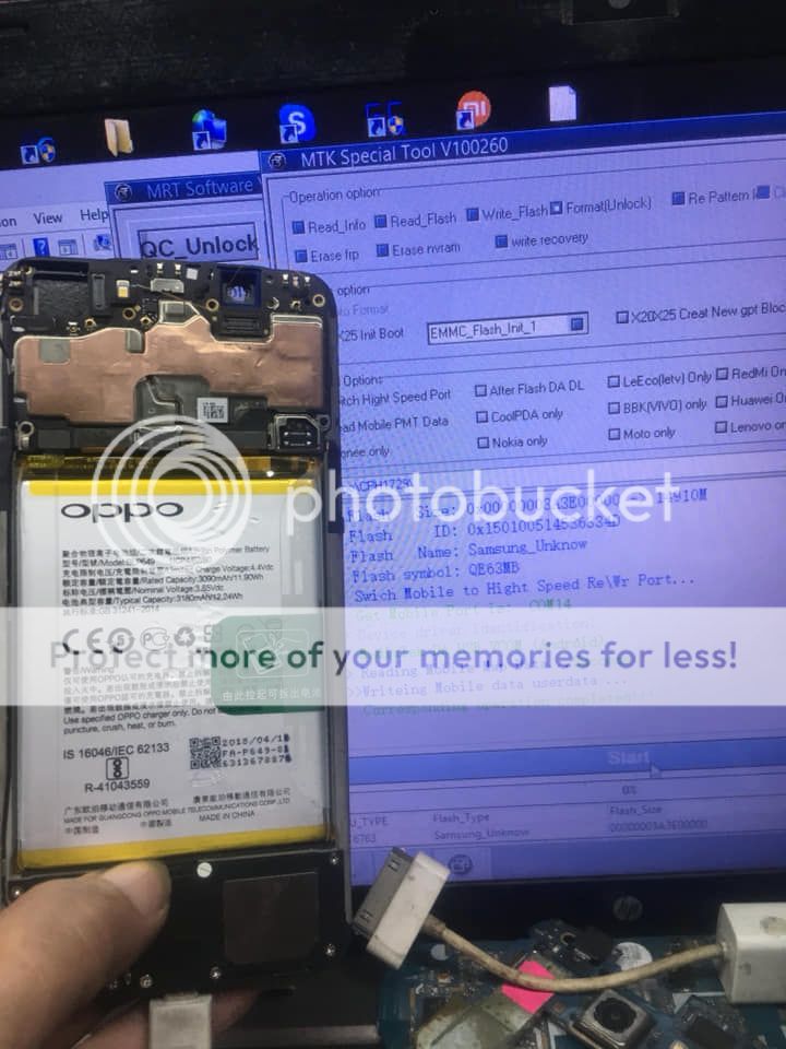

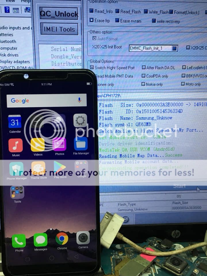

procedure to connect.
1. disconnect battery, lcd and camera

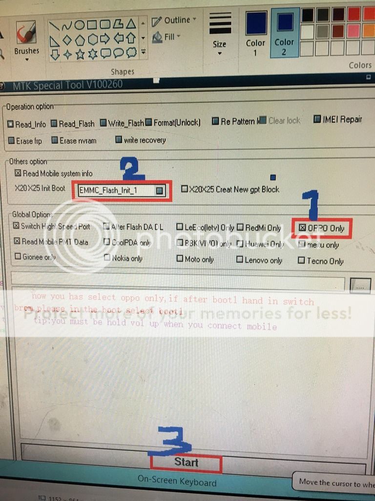

2. run mtk software
3. select oppo and EMMC_Flash_Init_1
4.click star the software
a. connect battery

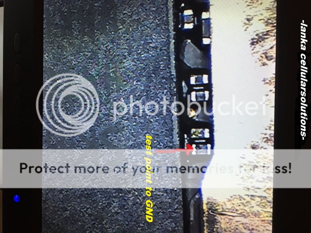

b. connect tp to the ground
c. connect usb,,when software run disconnect the tp..
jumper wire na may taas 3cm at lagyan ng soldering led sa dulo
Note mrt software ang gamit ko v2.60
