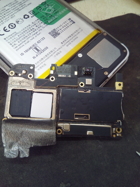

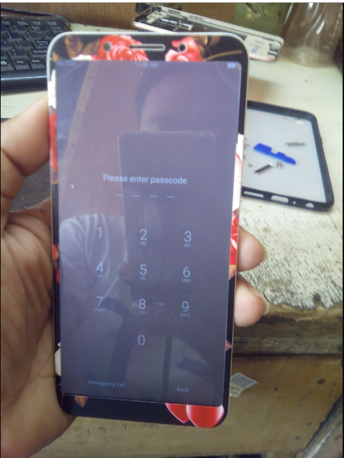

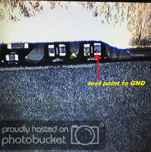

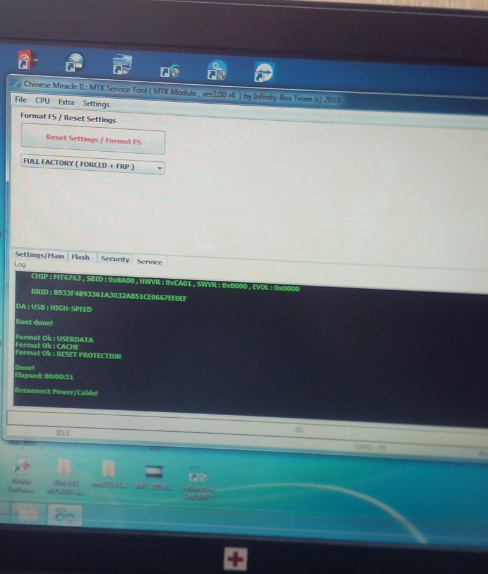

procedure........................
Run cm2 mtk module ver.2.00 r4
Select model oppo f5
Select service tab menu
Under reset settings, select Full Factory(forced + frp)
Click reset/format fs

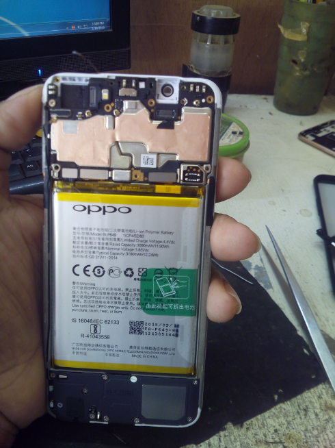

Connect test point to ground with battery kc hnd ma detect kng wlng battery pero ung gawa ng iba with out battery.
https://postimages.org/app

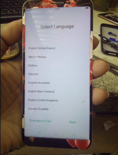

done
