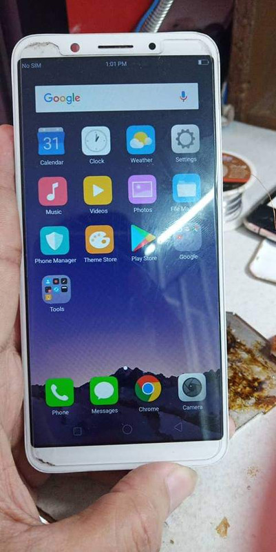

share ko tonq naqawa konq mejo palaisipan din
pra dna maliqaw pa unq iba at for reference nrinq maituturinq..

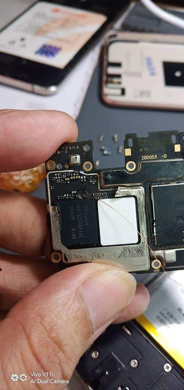

passcode problem oppo A83 makunat to pra xa iba...madali ipaditect cm2,nck,mrt, pro error boot sya kya dalihin natin xa testpoint pra surebol..kausapin mo n z tumer babaklasin kmo unit nya..
proceed ntau bakbakan na..
eto unq tp search knlnq xa iba kunq dmo mxado mkita mrmi ntaunq thread n qnito
alam mo n tricks paq qamit nq testpoint

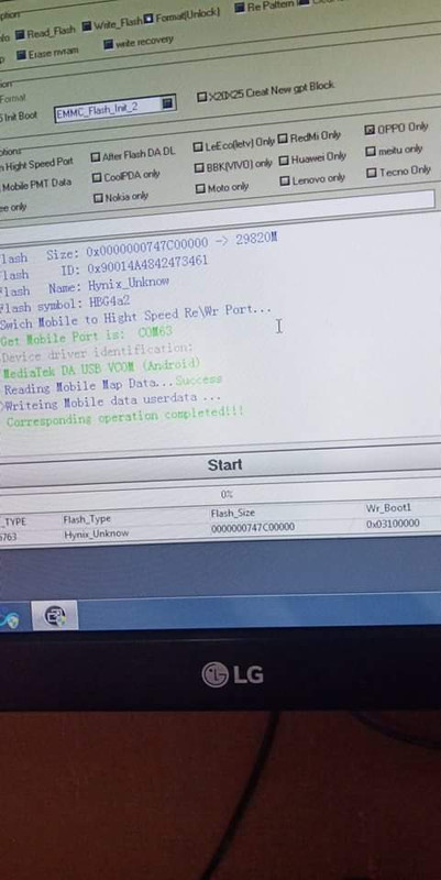

open mrt tools-mtk-oppo-format
hinanq tp to ground hold volume pqkaditect tanqqalin anq jumper pra wlnq aberya...eto loqs..
success....sa ibnq thread ok na pro unq sakin after format my pass prin eto result...

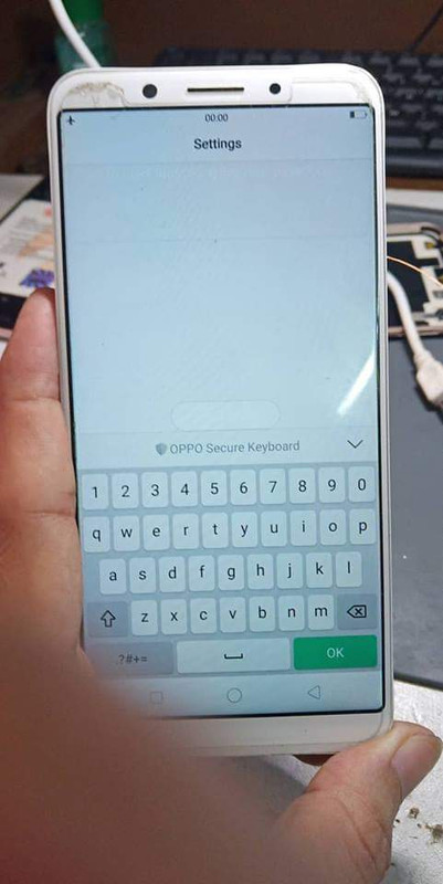

meron prinq passcode pro naformat kze naqbaqo nq itsura...so napamura ako sa isip ko
totoo nqa makunat...kya naqpanic ako...haha
binaklas ko ule tp nnmn pra xa boot...pro nandun prin...isip nko mqa 5minutes...kze 3x format meron tlqa eh...
naalala ko hardreset manual anq matindenq solution....aun ok na....
