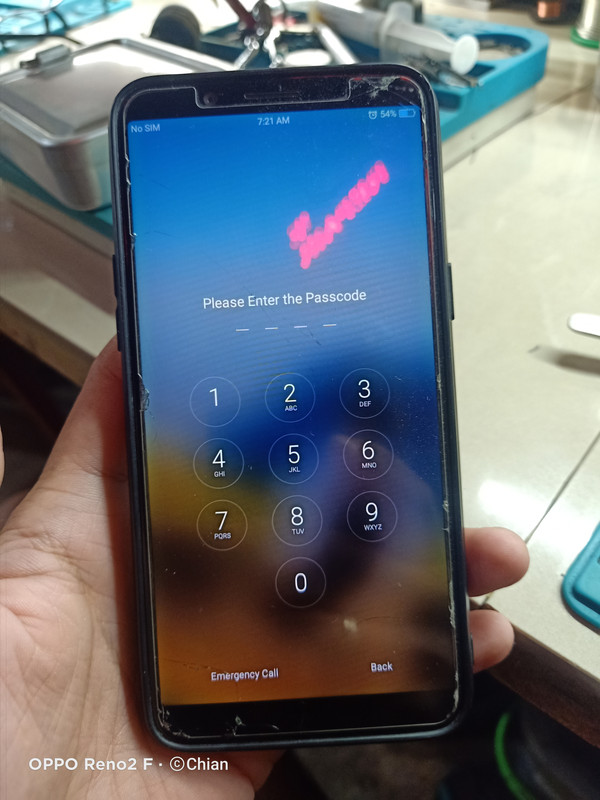

Hello mga boss. Today may recieve po ako oppo a83 password
pinalitan daw ng anak at dina daw alam so ayun naisip ko na matry sa unlocktool.

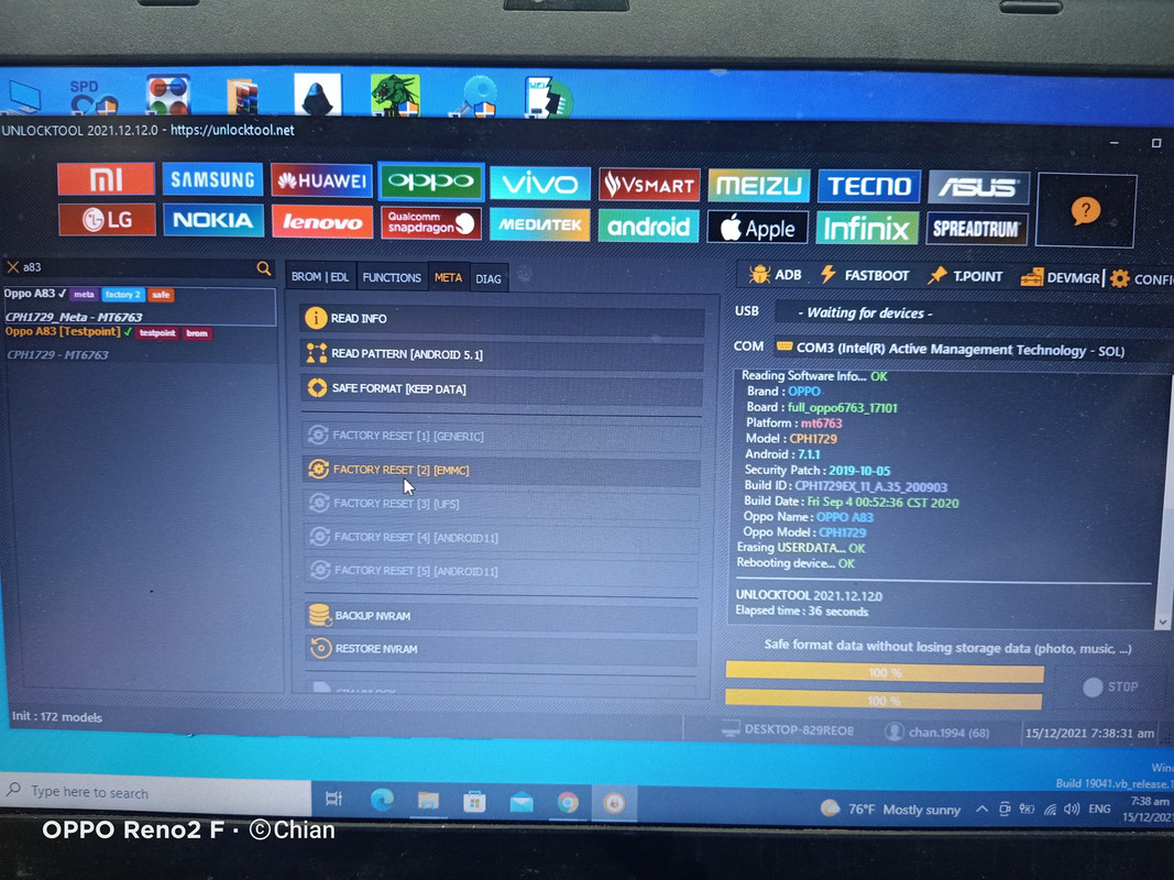

Open unlocktool and select Band 'OPPO' then search A83 'meta/factory/safe and click 'FACTORY RESET [2] [EMMC]
Now hold volume up and down and insert usb

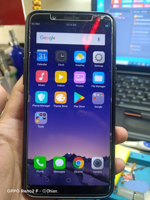

Pagkatapos ma reset frp problem naman. *#813# and go to setting and erase all data (fatory reset)
Heto po finish product ko
Heto po procedure.
