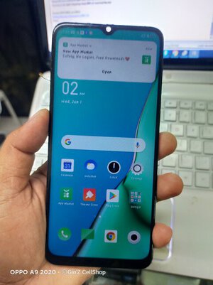

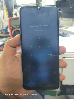

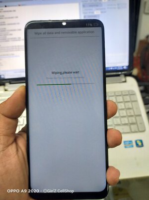

OPPO A9 2020 PASSCODE AND FRP ISSUE SUCCESSFULLY REMOVED
STEPS

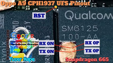

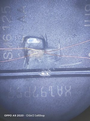

1.) SEARCH ISP/UFS PINOUT ON INTERNET AND DRILL CPU
2.) SOLDER ISP/UFS PINOUT

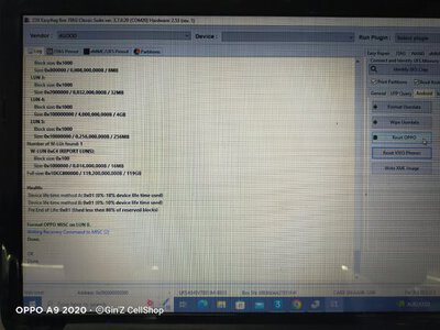

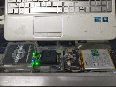

3.) CONECT TO EASY JTAG AND OPEN JTAG SOFTWARE AND SELECT ISP ON CONNECTION TYPE
4.) CLICK IDENTIFY UFS CHIP
5.) GO TO ANDROID TAB AND CLICK RESET OPPO OPTION AND ENJOY!
DONE !
