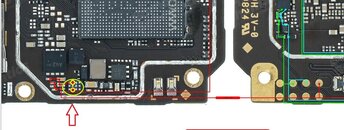

SHARE KO LANG PO ITONG TANGGAP KO GALING COTECH
OPPO A9 2020 PO
ANG PROBLEM BUHAY ANG UNIT PERO PAG CHINACHARGE
NAMAMATAY ANG SCHEMATIC CHARGER
NAG PALIT NA DAW SIYA BAGONG CHARGING BOARD SAME PROBLEM PA RIN
ITO ANG 1ST TROUBLESHOT NA AKING GINAWA
OPEN BORNEO PARA SA GUIDE
BUHAY ANG UNIT KAYA WALANG PROBLEMA SA VBATT NYA FUCOS TAYO SA VBUS IN NYA KUMUHA AKO TESTER
SET INTO DIODE MODE
BASE KAY BORNEO AND DAPAT NA MASUKAT NATEN AY 0.465
PERO ANG NASUKAT NG AKING TESTER 0.001 SHORT TO GROUND ANG LINE NI VBUS.
KAYA GINAWA KO NG INJECT AKO NG VOLTAGE KAY VBUS PARA MAKITA KO ANG PROBLEMA NYA
USING THERMAL SCANNER ANG PROBLEMA PALA AY SI OVP IC
KAYA GINAWA KO INALIS KO SIYA TAPOS BYPASS KO ANG LINE NYA
PINAG DUGTOG KO LANG ANG DALAWANG RED DOT ( SEE PICTURE )
TAPOS DIODE READING ULIT SA VBUS IN KUNG NORMAL NA BA ANG READING NYA
AT NAG NORMAL NA NGA SIYA .
NAG CHARGE NA RIN PO SIYA .
ITO LANG PO ANG AKING MUNTING AMBAG SALAMAT PO .
