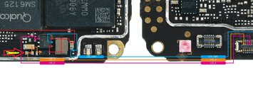

BASE KAY BORNEO DAPAT AY MAY MASUKAT TAYONG 0.576 LED A ( ANODE )
PERO SA UNIT NA TANGGAP KO AY OL ANG READING OPEN SIYA .
UPON CHECKING PRESENT ANG 0.576 RESISTANT VALUE NYA USING DIODE MODE LED A SA INPUT NI RESISTOR
( YELLO ARROW )
PAG DATING SA OUT PUT NI LED A WALA AKONG MAKUHANG READING
( RED ARROW )
KAYA PALA WALANG BACKLIGHT KASE HINDE NAKAKATAWID ANG
VOLTAHE PAAKYAT SA FPC OR TERMINAL NG LCD PO

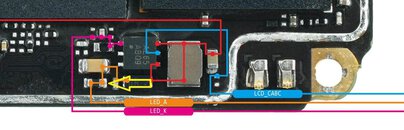

KAYA GINAWA KO PINALITAN KO UNG RESISTOR PO.
.49 OHMS
ANG GINAMIT KO KUMUHA AKO SA LIGHT SECTION NI OPPO A5S .
MATAPOS MAPALITAN ANG RESISTOR AY NAG NORMAL NA ANG READING NA AKING NASUKAT HINDE NA SIYA OL
AT PAG TESTING SA UNIT AY LUMIWANAG NA PO .
